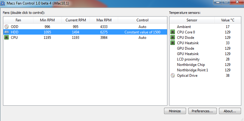

I replaced my defect HDD in a iMac 10,1 (mid 2009) with a 2GB WD (WD20EZRX).
I now installed Win7 64bit in Bootcamp and found Mac Control to control the fan for me. I was very happy :D
However - the program do not detect the temperature of the HDD and therefore I cannot set it to a sensor based value.
Please advice if I need to do something?
Thanks.
PS: Other programs have detected the HDD temp via SMART so the hardware should be ok.

Do you see your new HDD in the list of sensors?
Please post a screenshot of Macs Fan Control.

Here a screenshot.
As you can see the CPU temp seems to be... a bit off.
Re: Fan Control cant find HDD temperature
Thank you, please also copy technical info from the about dialog here.
There's an issue in beta 4 - all items with 129 C value are incorrect, these sensors are not supported. Please ignore them for now.
The main problem I see here that your HDD is not supported :(

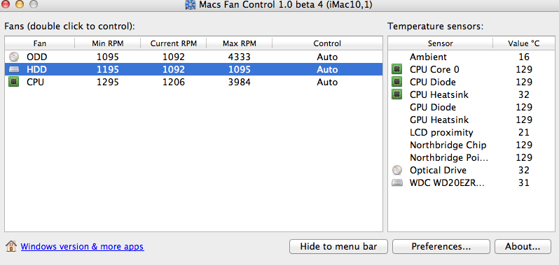

I use another fan control software for OS X.

I tried to use it on OS X. I have attached the screenshot.

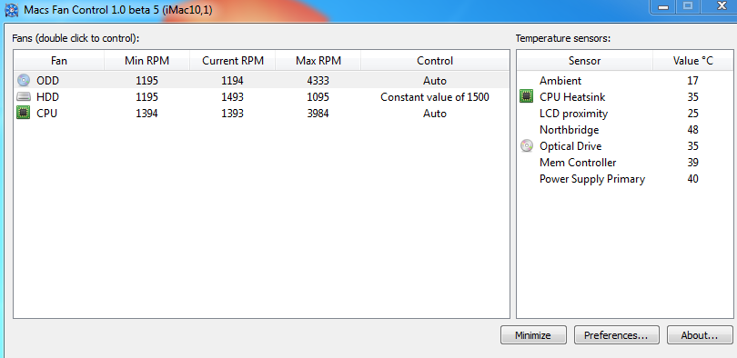

Thats strange. I do not get any more in the log file even when I exit the program and restart it.
When I reinstalled the program I wondered why the speed of the fan was set to 1500 rpm. This was the setpoint I used on the "old" program, i.e. before I reinstalled the newest version of the program.
I am out of my league here, but is there a configuration file somewhere that needs to be reset?
The new installed program started very quick also - I do not suppose it was scanning a lot of adresses.
