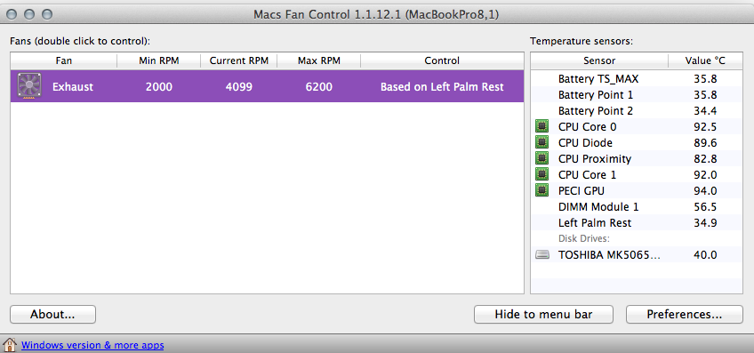

Based on that what would you set the settings to based on these options available from the attached screenshot?
Screen Shot 2014-08-05 at 15.34.40.png (72.6 KiB) Viewed 18961 times
Re: Optimal settings Macbook Pro (8,1)
steveyeu
100 is max for your CPU, as I've said.
Correlation to Left Palm Rest is definetely not correct.
Try experimenting, maybe Automatic control will be fine for most of the cases.

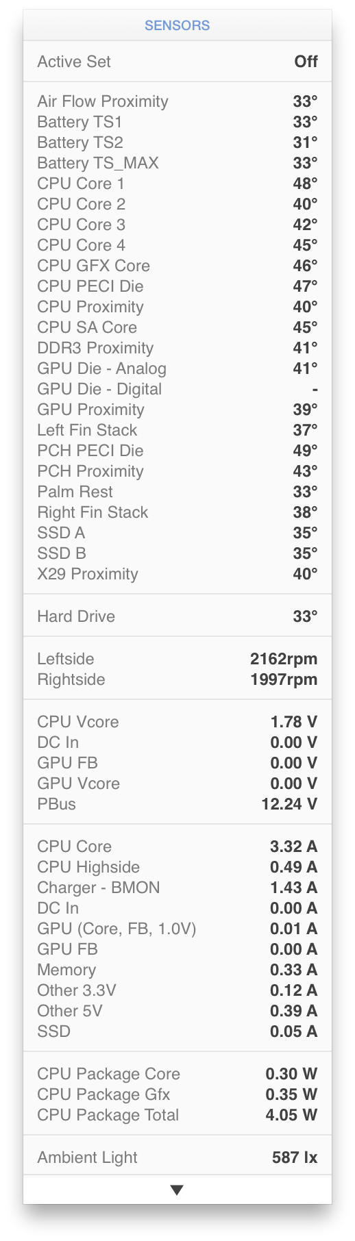

I would point settings to look at the left fins on the heat sink. iStat Menus has 25 different temperate readouts on the retina MBP machines, Mac Fan Control only lists 11, and the heatsink temperature is one that is missing.
