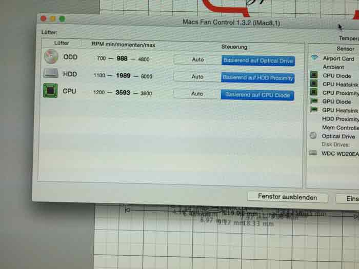

I replaced the HD in an iMac 24" 2009. Of course, the fan was blowing like hell with the new HD, I installed Macs Fan Control with the options on the attached picture.
It works fine, but after an hour app. the fan begins to blow harder again. I also can see, that the recent level of the CPU is getting higher and higher right now.
Any idea what could help or what I'm doing wrong?

Re: Fan starts to blow fast after working app. 1 hour
Hello krakenadler,
why you assigned HDD sensor to CPU fan?
the CPU fan control CPU/GPU/PSU sensors (iMac 8,1).
Try to assign:
ODD fan - auto or Optical drive
HDD fan - HDD proximity
CPU fan - GPU Diode or CPU Diode (normally the GPU temp is more critical)
In this mode I found a good equilibrium on my iMac 2008
Have a nice day.
Try to assign:
Have a nice day.
Thanks, it seems to work!

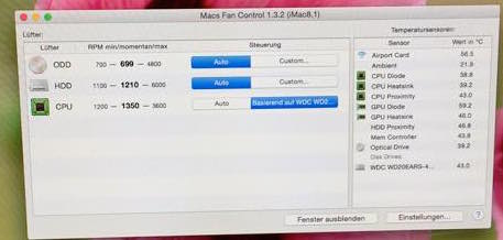

Hi
today I found this settings. Any suggestions what to edit?
Tom
