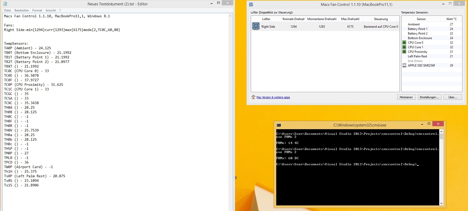

Hello, can you please show MFC main window screenshot running on your mac?
Walter
Joined: 01 May 2014, 18:03
Re: RPM Calculation
Post by Walter »
Here it is:
Re: RPM Calculation
Walter

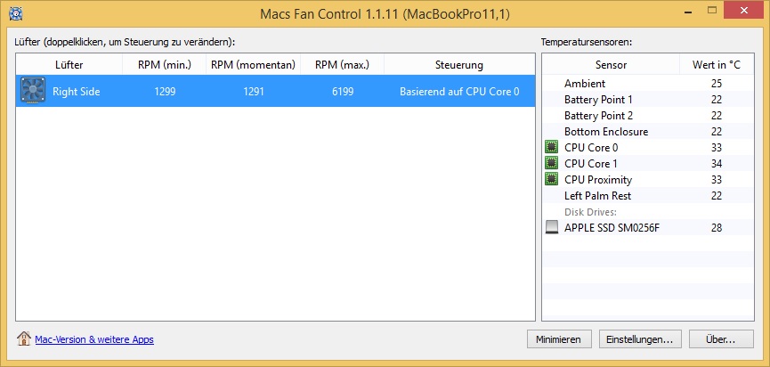

Thanks for the help! You seem to be correct, please try the newest version 1.1.1 (available for Windows only at the moment):
A screenshot of the 1.1.11 window is appriciated.
Walter
Re: RPM Calculation
Post by Walter »
Hey that was quick :smile:
They match now, thank you!
Re: RPM Calculation
Fixed for Mac as well! Thanks
