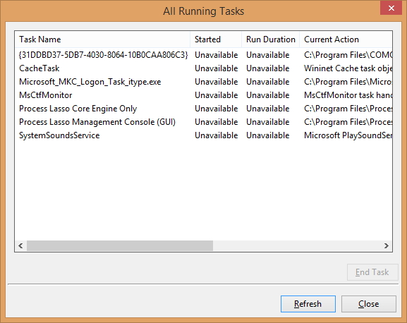

Re: Uninstall Tool 3.4.1 beta
You mean the All Running Tasks?
mad
Not only running, but all available tasks.

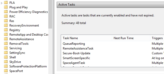

I searched, but could not find the mentioned "RunUninstallTool_SkipUac".
I searched at left and bottom pane (see screenshot).
If I am still missing something, please give more specific instructions.
mad
Please re-download the beta again.
UAC elevation shouldn't be asked in two cases
- When running the app from desktop icon
- When Install Tracker is executed from context menu
