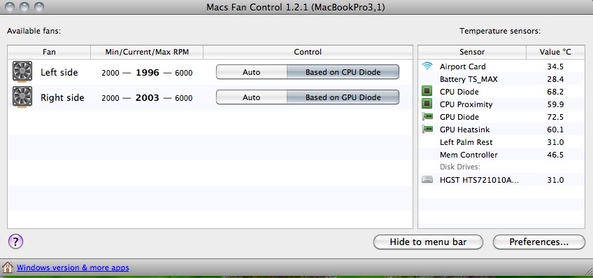

Must? This is just my point - it does NOT start minimized.Steven wrote: it must start /minimized
..., even after applying this command in Terminal.Also you can try using command line
Upon starting up, or re-booting, either of my machines into Mac OS 10.6.8, MFC's main window appears, unbidden and unwanted.

Re: Drop support of OS X 10.6
My Tech Info:
- MFC Main Window.jpg (82.07 KiB) Viewed 57805 times
fbl
Issue confirmed, will look at at. the thing is that I don't have a mac with 10.6
Must have been fixed, please re-download the legacy 10.6 version
Must have been.
Thanks very much.
