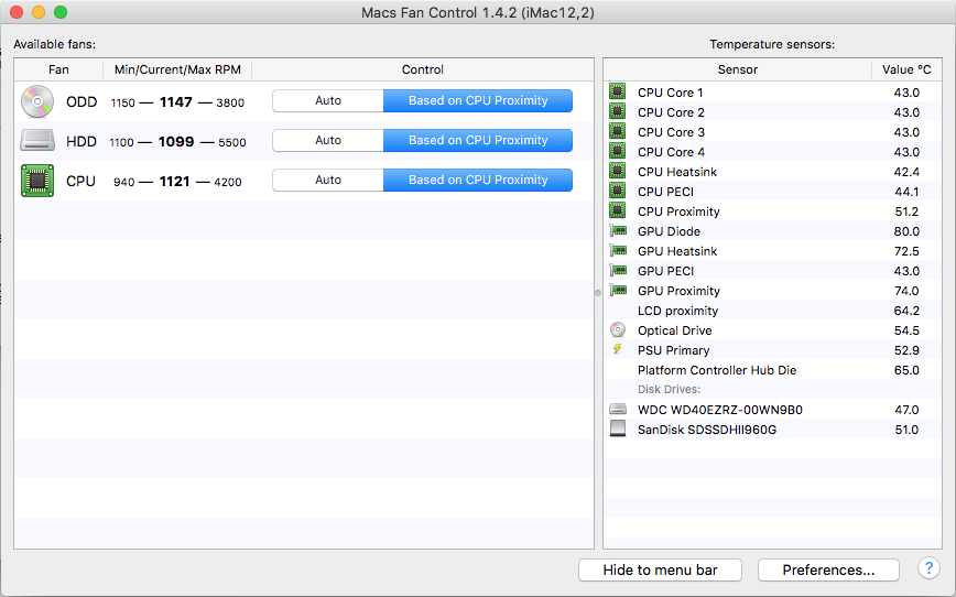

What are the min and max temps for the CPU, HDD & ODD fans if I set them to CPU Proximity?
I have just had my iMac repaired, the GPU popped, as did the temp sensor connection on the logic board. The repair centre installed Macs Fan Control and I can now hear myself think while I'm working. (The noise created by the fans running flat out was unbearable).
What is considered to be the maximum CPU proximity temperature?
What temperature can I safely set the CPU proximity fan to "Start to increase from"?
Below is the data requested:
Macs Fan Control 1.4.2
iMac12,2
CPU: Intel(R) Core(TM) i7-2600 CPU @ 3.40GHz [100]
GPU: Intel HD Graphics 3000 [active], AMD Radeon HD 6970M
Mac OS X 10.11.4
ODD-min{1150}curr{1149}max{3800}mode{2,TC0p,79,90}
HDD-min{1100}curr{2155}max{5500}mode{2,TC0p,66,78}
CPU-min{940}curr{1189}max{4200}mode{2,TC0p,50,63}
TA0P () - -1, 128
TA0V () - -1, 128
TA0p () - -1, 128
TC0H () - 42.125, 42.125
TC0P () - 51.125, 51.125
TC0c (CPU Core 1) - 44, 44
TC0h (CPU Heatsink) - 42.125, 42.125
TC0p (CPU Proximity) - 51.125, 51.125
TC1c (CPU Core 2) - 41, 41
TC2c (CPU Core 3) - 43, 43
TC3c (CPU Core 4) - 41, 41
TCGc (GPU PECI) - 44, 44
TCSc () - 45, 45
TCXc (CPU PECI) - 43.9531, 43.9531
TG0D () - 80.125, 80.125
TG0H () - 72, 72
TG0d (GPU Diode) - 80.125, 80.125
TG0h (GPU Heatsink) - 72, 72
TG0p (GPU Proximity) - 74, 74
TH0O () - 9, 9
TH1O () - 6.01562, 6.01562
TL0P () - 52.5703, 52.5703
TL0V () - -1, 128
TL0p (LCD proximity) - 64, 64
TL1P () - 56.25, 56.25
TL1V () - 28.082, 28.082
TL1p () - 56.25, 56.25
TL1v () - -1, 128
TL2V () - -1, 128
TLAV () - -1, 128
TLBV () - -1, 128
TLCV () - -1, 128
TO0P () - 53.25, 53.25
TO0p (Optical Drive) - 54.25, 54.25
TPCD (Platform Controller Hub Die) - 64, 64
TS0P () - 49.25, 49.25
TS0V () - 46.6797, 46.6797
TS0p () - 49.25, 49.25
TS2P () - 47, 47
TS2V () - 44.1445, 44.1445
TS2p () - 47, 47
Tm0P () - 54.75, 54.75
Tm0p () - 54.75, 54.75
Tp1P () - 54, 54
Tp1p () - 54, 54
Tp2H () - 67, 67
Tp2h () - 67, 67
Tp3H () - 53, 53
Tp3h (PSU Primary) - 53, 53
WDC WD40EZRZ-00WN9B0 - 47
SanDisk SDSSDHII960G - 51
