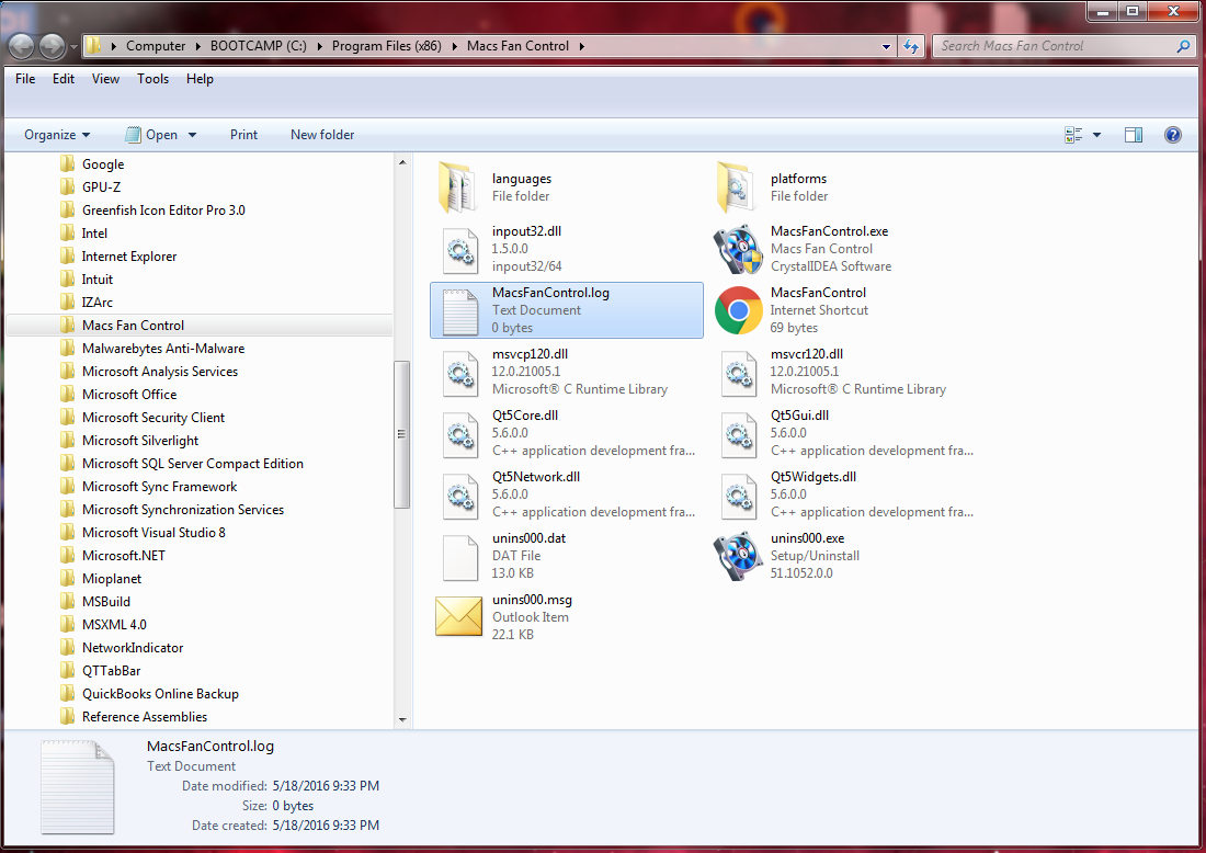

No error messages
and the log file is 0 bytes.
- screen shot of Mac Fan Control install directory.
- Capture1.PNG (219.8 KiB) Viewed 156772 times

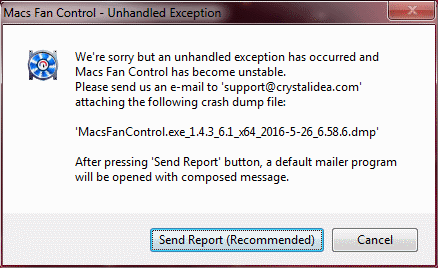

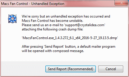

I installed the "dev" install and got an error from Windows, I wasn't able to get a screen shot of it but I did check the Windows Event Viewer and this is the output: (there are 2 entries)

Sorry for the delay. I downloaded and installed this "...dev_2.exe" install. The install completed and it asked I wanted to start Mac Fan Control. The app started with no error messages.
When I restarted my Mac in Windows 7 I got the following error: see attachment "MFC-UnhandledException_1.4.3_61-2015-05-26.png"
I'm also including the ".log" file (had to zip the file, posting the 1.05MB file to the forum gave an error) and ".dmp" file (had to zip the file, same reason as the log file), see attachments.
Is there something else I can try?

- MacsFanControl.exe_1.4.3_6.1_x64_2016-5-26_7.1.55.dmp.zip
- (10.89 KiB) Downloaded 4956 times
- MacsFanContro.log.zip
- (57.07 KiB) Downloaded 4451 times
- MFC-UnhandledException_1.4.3_61-2015-05-26.png (16.35 KiB) Viewed 156722 times

I uninstalled the old version of MFC and installed this version and I got the following error message (see screenshot: "MFC-UnhandledException_1.4.3.272_6.1_2016-5-27_19.13.5_dmp.png"). I have also included the ".dmp" file, I've zipped it up.
- MacsFanControl.exe_1.4.3.272_6.1_x64_2016-5-27_19.13.5.dmp.zip
- (8.62 KiB) Downloaded 4370 times
- MFC-UnhandledException_1.4.3.272_6.1_2016-5-27_19.13.5_dmp.png (16.27 KiB) Viewed 156709 times
