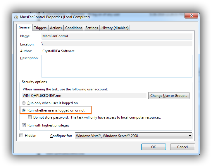

What if you put this option to the windows task (created by MFC):
- sshot-2016-05-26-[12-27-14].png (59.15 KiB) Viewed 25663 times
