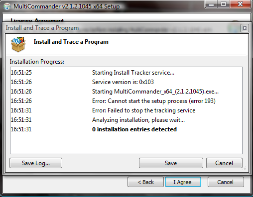

Install and Trace: Error 193
I have yet to get the trace install to work.
Have tried on several program.
Typically an error 193 means not a win 32 application.
This issue needs to be addressed please.
The Speccy of the rig with issue:
http://speccy.piriform.com/results/0Sni ... YpUmWpSRnH
- imss05062012_02.png (64.02 KiB) Viewed 415983 times

It's a 64 bit Vista! 4 core Phenom 9550
see the speccy.
I have tried several installs some X86 and some X64.
Not ignorant to such matters.
I test and review about 40 -50 programs a week.
I'm having no problems installing or uninstalling. The uninstall tool is wonderful, misses a few things now and then, yet still very good.
The issues is only with "trace and install". . . has not worked once on over 30 attempt. Always the same error as shown.

Re: Error 193
Scientific Frontline
I apologize for being not attentive.
Please answer the following questions to help us get more info on the issue:
1. What is Uninstall Tool version?
2. Are you running 'MultiCommander_x64...exe' from Uninstall Tool window OR using a context menu ('Install and Trace') on the .exe file?
3. What if you put the 'MultiCommander_x64...exe' to a root drive ('C:\MultiCommander_x64...exe') and start Install Tracker from there?
Thank you.
PS. I must admit it's all very weird and it's the first report of such matter, Windows reports error 193 when the .exe format is not valid.

Re: Error 193
Actually one other has.
http://www.crystalidea.com/forum/viewto ... t=193#p759
Ok Version: 3.11
I have tried on several using both methods. (context menu and through the program)
Always same error and always the error come up instantly.
Usually very good on trouble shooting, yet I seem to be overlooking the obvious somehow.
All programs can be installed in the normal manner.

Fixed in 3.3.3 Build 5321. It took ages to reproduce the problem, we're really sorry
