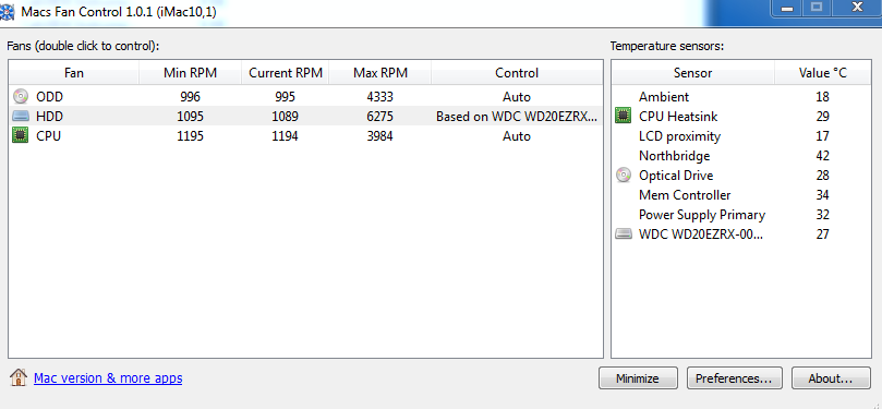

Hi
I just upgraded to the newset version of your fine program.
But now the minimum rpm is higher than the maximum rpm.

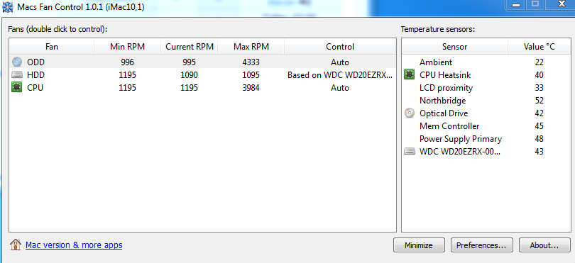

And the temperature is 43C - it should start increasing fan speed at 42C but nothing (or very little) has happened.

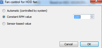

Furthermore I cannot set the rpm speed manually. I cannot erase the "old" rpm and put in new ones.
What to do?
BR Mikkel

Notice that someone changed Max RPM (dangerous!) and set it below Min RPM, MFC cannot set RPM higher than Max RPM for safety reasons.
Try put mac to sleep and then wake

Hi again
Earlier I rebooted the computer and it didnt help. This time I shut it down for some hours. And now everything works fine... Dont know why - but its all good now :smile:
Re: min RPM higher than max RPM and MFC not increasing speed
Reboot will not help, sleep/shut down should help to reset SMC values of fans
