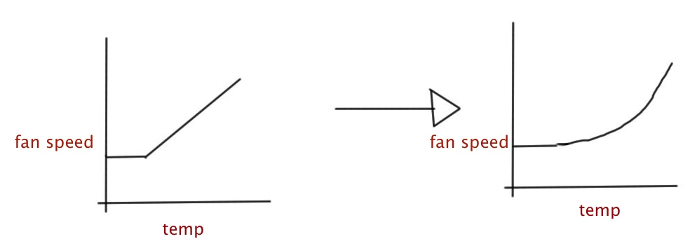

Another idea!
You could implement a graphing section where the user can map his own personal curve of how the temps affect fan speed! That can be really usefull when looking to fine tune your cooling according to what you do. The ability to save different curves as modes is a plus!
I think that what holds macs fan control back is the algorithm and then the linear response of the fan speed according to the temps.
ps. i know crude drawing but you get the idea.

Yeah I'm at math university myself so I know what you mean..!
You can actually make use of this idea by breaking down the curve to small linear parts! How small is all up to you! Pic like 5-or more- points on the curve, make linear equations using two consecutive points, and you will have like an estimate of the curve. The math could be simpler that way!
I'm not sure but in that way you could make speed changes in fan speed more dramatic, depending on the tilt of the linear equation.
ps: I write a little bit of code myself and I could helf you out with the math part, but now I'm like in a bit of a struggle with some final exams so it is out of the picture for me. Maybe in the end of 2014- start of 2015.
