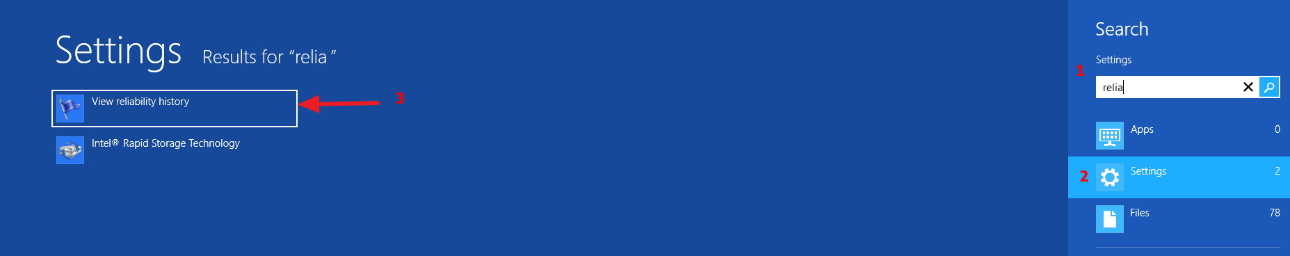

Re: Errors in Windows 8 Reliability manager log
"You cannot post attachments in this forum"
So I tried imageshack, hopefully it will work.
http://imageshack.us/g/820/utoolcrashes.jpg/
1. Yes, see screenshots. It is the RTM version.
2. I was not able to reproduce the issue. It is weird, check the dates of the errors... several times in one row, then longer time nothing...
**EDIT**
3. I was checking the crash logs, and the only thing that is changing is the utool version number. See previous log: Application Version: 3.2.1.5279 ... every crash log has another number (e.g. 3.2.0.5272 / 5274 / 5276). So now I am thinking, it is probably a problem with installation, or starting the application from the installer itself.
**EDIT**
1. As you have seen, I have an Intel CPU, so it is not the RT version, but also not Pro or Enterprise, just the regular Windows 8 version x64.
2. All the logs are exactly same as the one I posted earlier.
3. Control Panel\System and Security\Action Center\Reliability Monitor -> View all problem reports (menu located at the bottom of settings screen)
4. Build downloaded this morning (UTC +01:00) from your site. Registered version, I have bought a license. Utool 5279 without any alteration, just downloaded and installed.
5.
6. I have now reproduced the issue several times, and it is getting worse.
I have installed the new 5279 over the existing installation. I was able to start utool from the installer (start app after installation finishes). But then when I close utool and try to start it again, I get an UAC promt, then utool does not start. I cannot start utool afterwards - only if I install it again, then it works only from the installer. Sigh, I will try a PC restart to see if the helps. **Nope, cannot start utool normally.

Update. Same thing. A funny moment is that I can't find the Reliability Monitor:
thanks for helping me troubleshoot this.
I always find Reliability Monitor this way: 1. go to Search (right corners of the screen), 2. Type: reliab (you do not need to write the full word), 3. select Settings (under Apps, just right under the search field).
But it does not matter so much now, as I have found the culprit, it is Avast!
If I disable Avast realtime shields, I can open utool without a problem. Also no more errors.

It must sound strange, but it's not there (Reliability Monitor). Never mind

Nevertheless, thanks Steven.
It is really weird that you cannot find the reliability monitor. It has been around at least from Win7, if not from Vista. Maybe it will not activate in WM? Who knows ... posted a screenshot
And I fixed the Avast problem (yes, free version) by myself. I added utool to exclusions under the "Behavioral Shield". No error as of now and utool can be launched normally. I hope it stays that way.

- reliability.jpg (94.7 KiB) Viewed 96164 times
