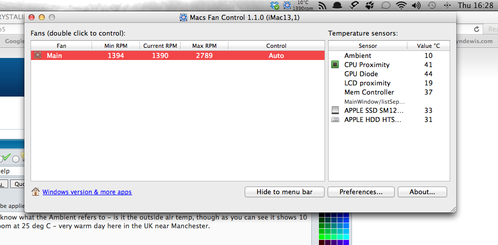

Just started to play with Macs Fan Control.
To what does the ambient temperature refer- is the room temperature?
My imac has been on all morning in a room that is at 23deg C.
The software says the Ambient is 8 deg C and fan speed 1392rpm - normal imac fan speed.
So again, what is the Ambient temp referring.
iMac is the latest 2012, 20 inch version.
Im running the software as a trial as I think it will help sort a diagnosis problem on a 2009 imac thats coming to me.

Just want to know what the Ambient refers to - is it the outside air temp, though as you can see it shows 10 deg C in a room at 25 deg C - very warm day here in the UK near Manchester.

Ambient usually tells about air temperature in the iMac case. 10 is really strange
Please press the button "Copy technical info" and share the output

As requested here is the techie bit.
Steve
ps current room temp 21 degC and ambient reads 5 deg C.

Think I forgot/ or failed to attacment the word dock of techie stuff so here it is pasted in.
Steve
Macs Fan Control 1.1.0, iMac13,1, Mac OS X 10.8

Re: Ambient help
thank you, it looks like this value is not correct on imac 13,1, just checked another iMac.
What is min, max value for Ambient on your iMac? (approx)

Re: Ambient help
Just empirical, visually. Does it change actually?

Came across a thread regarding iStat - a similar thing I believe and several people with new 2012 iMacs have an ambient reading of around 9 degrees - their gurus suggest its a programme thing making the software incompatible as far as ambient readings go.
Steve
ps I have just installed the same version of Macs Fan Control 1.1.0 (imac13,1) on to a 2008 intel iMac with Mountain Lion and the ambient there is 25 deg C - room temp is around 24 deg C.
Hhhmmmm

me again, over the last hour the ambient has flicked from 9 degC to 7 deg C and back again.
As far as I can tell the room has stayed at a constant temp too.
Steve
Re: Ambient help
It looks like this sensor should be removed when running MFC on iMac13,1, as its value is not correct (9 deg C is not possible inside a computer)

Re: Ambient sensor help
Well, шt's very simple to remove this sensor, for now you can simply ignore its value. Currently need some more data to remove it - ithere're only 2 computers with the same issue. If it's systematic - the sensor will be removed.
Fixed in 1.1.1
