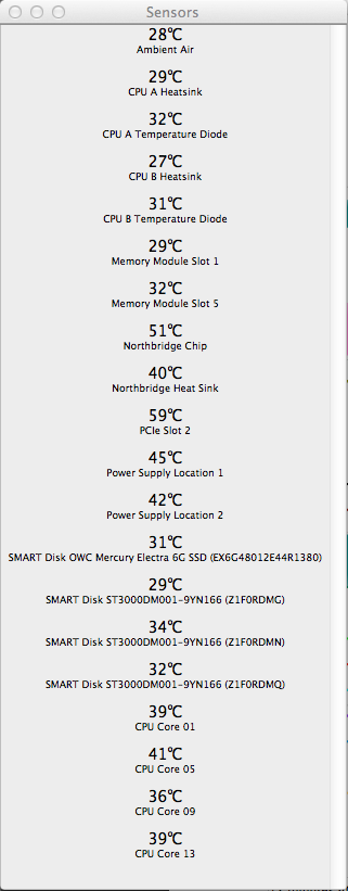

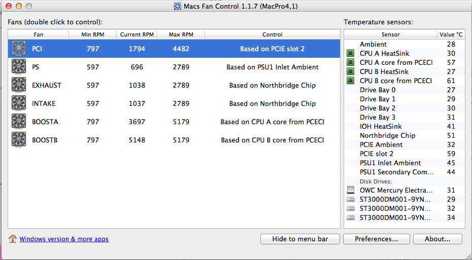

Love this little app and its getting better all the time. My issue at this point is the CPU A and CPU B "core from PCECI" temps do not agree with the values displayed by Temperature Monitor. This is driving the BoostA and BoostB fans to high speeds.
Mac Pro - Early 2009 - 2 x 2.66 GHz Quad-Core - OS X 10.8.5
You can see that most sensors match, but not the CPU core temps:
Sensor MacsFanControl TempMonitor
Ambient 28 28
CPU A heatsink 30 29
CPU A core 57 32
CPU B heatsink 27 27
CPU B core 61 31
Northbridge chip 51 51
Northbrdige heatsink 41 40
PCIe Slot 2 59 59
Ambient 28 28
CPU A core 57 32
CPU B core 61 31
PCIe Slot 2 59 59
- TempMonitor.png (66.21 KiB) Viewed 30623 times
- MacsFanControl.png (126.17 KiB) Viewed 30623 times

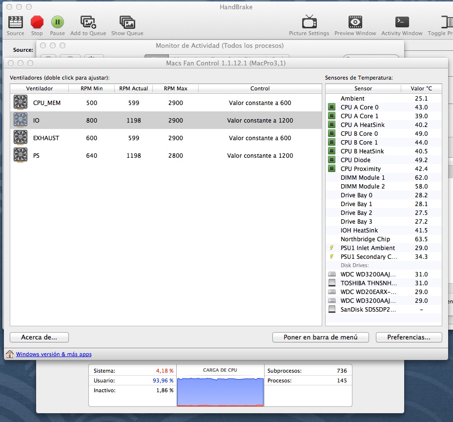

Re: 2009-2012 Mac Pro CPU core temps
Same for MacPro 3.1
Core Temp may not differ much from the heat sink or diode temperature, otherwise we would all have bad thermal paste between the CPU and the heatsink.
- mac pro 3.1 temps.png (112.3 KiB) Viewed 29830 times

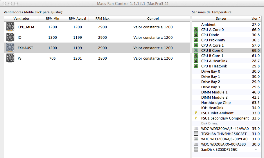

AGUSTIN
Can you test temperature with 100% CPU load? CPU A(b) Core temperatures raise or fall down?
Please run this test as well:
http://forums.crystalidea.com/viewtopic.php?f=11&t=1073
the core temps low down at 100% cpu load.
- output.txt
- (127 Bytes) Downloaded 2231 times
- Core Temp down.jpg (239.36 KiB) Viewed 29819 times

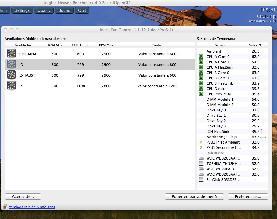

By the other hand, the Northbridge Chip temperature is not working for me. With high IO activity, the IOH Heatsink (Northbrige heatsink) temperature rises, but the Northbridge Chip Temperature not.
- north ko.jpg (200.09 KiB) Viewed 29819 times
heatsink doesn't look high as well at 100% load.
Do you really think that actual temperatures for CPU A(B) Cores should be (85C - current value)?
85C is Tj max for your CPU.
I don't understand your question. As CPU load rises, the heat sink temperature rises but displayed Core Temperature fall down.
Maybe:
RealCoreTemp=Tjmax-DisplayedCoreTemp
Maybe:
AGUSTIN
That's exactly what I mean. TjMax for your CPU is 85C, then
RealCoreTemp=85-DisplayedCoreTemp
does that look right? Can you check it with Temperature Monitor Lite or some other software?
Fixed in 1.2 version. Available as beta at the moment
