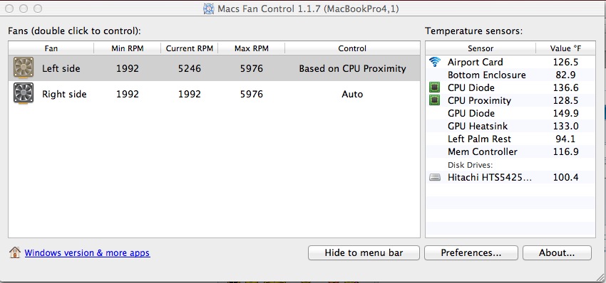

So, that out of the way, and while I still don't have an answer to why my fan speed was ramped up - including the shown "Min RPM" in the MFC Preferences window - after submitting that report I shut down and removed both the power cord and the battery, leaving the computer that way for 4 hours. I rebooted just a few minutes ago and now only one of the fans is out of control (see screenshot). Note one fan uses "CPU Proximity" control, while the other is set to "Auto" to establish fan speed.
If I switch that left fan to "Auto", as well, the speed immediately drops to c. 2000rpm. I'll leave it there for now, though I'd prefer a system that seemed somewhat more balanced, regardless of what the trigger sensor might be, and that didn't set an arbitrarily high minimum speed for the fans.

- Screen Shot 2014-01-15 at 5.15.32 PM.jpg (80.11 KiB) Viewed 10304 times
Re: minimum speed is too damn high!
Current minimum speed is correct and matches default value (both fans).

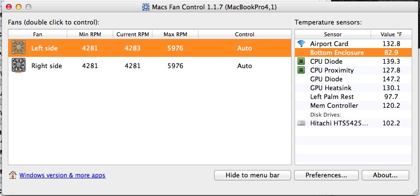

Me, again.
I woke up this morning and noticed I could hear my laptop's fans as I walked by. Unusual, as it was idle at the time. When I sat down with it I checked the readings on Macs Fan Control and saw a. the fans WERE running high and, b. my previous settings - including designating "Automatic" as the fan speed control criteria - were still in place. Since the System's minimum is about 1200 it's confusing that this readout displays 4281rpm. (In screenshot below you see "Bottom Enclosure" highlighted; that's only because I was scrolling through the options to see if that made any difference to the displayed minimum speed. It did not! But I think most would agree these readings are not particularly high.)
The other mystery is that at some point since my last post the settings changed on their own - at least, that minimum speed dictated by Macs Fan Control has changed. Hope the accompanying info helps track down the cause.
Here's the tech detail:
Macs Fan Control 1.1.7, MacBookPro4,1, Mac OS X Unknown (Edit: OS 10.9.1)
Left side-min{4281}curr{4283}max{5976}mode{0}
Right side-min{4281}curr{4281}max{5976}mode{0}

- Screen Shot 2014-01-21 at 10.30.57 AM.jpg (84.85 KiB) Viewed 10253 times
I see two possible reasons:
1. Misfunctioning of SMC service in your macbook
2. Some other software is still running and increasing the minimum speed.
