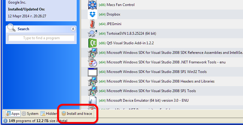

It works in portable version, there's a button 'Install and Trace'

Please run the portable version and look at it. I cannot find that button. I do not think it is there.Steven wrote:jackerbes
Again, I am running the portable version of Install Tool, I have no context menu or start menu to find that 'Install and Trace' button on because I am running Install Tool from a flash drive.

Here it is:
- sshot-2014-03-12-[1].png (68.63 KiB) Viewed 22085 times
Re: Autodesk LT 2014 uninstall
OK, there it is. I must be stupid after all.
I see I have to elect to use it before I run an install. So it is too late for it to help me with the last install on AutoCAD LT 2014. But I will install again and use it.
