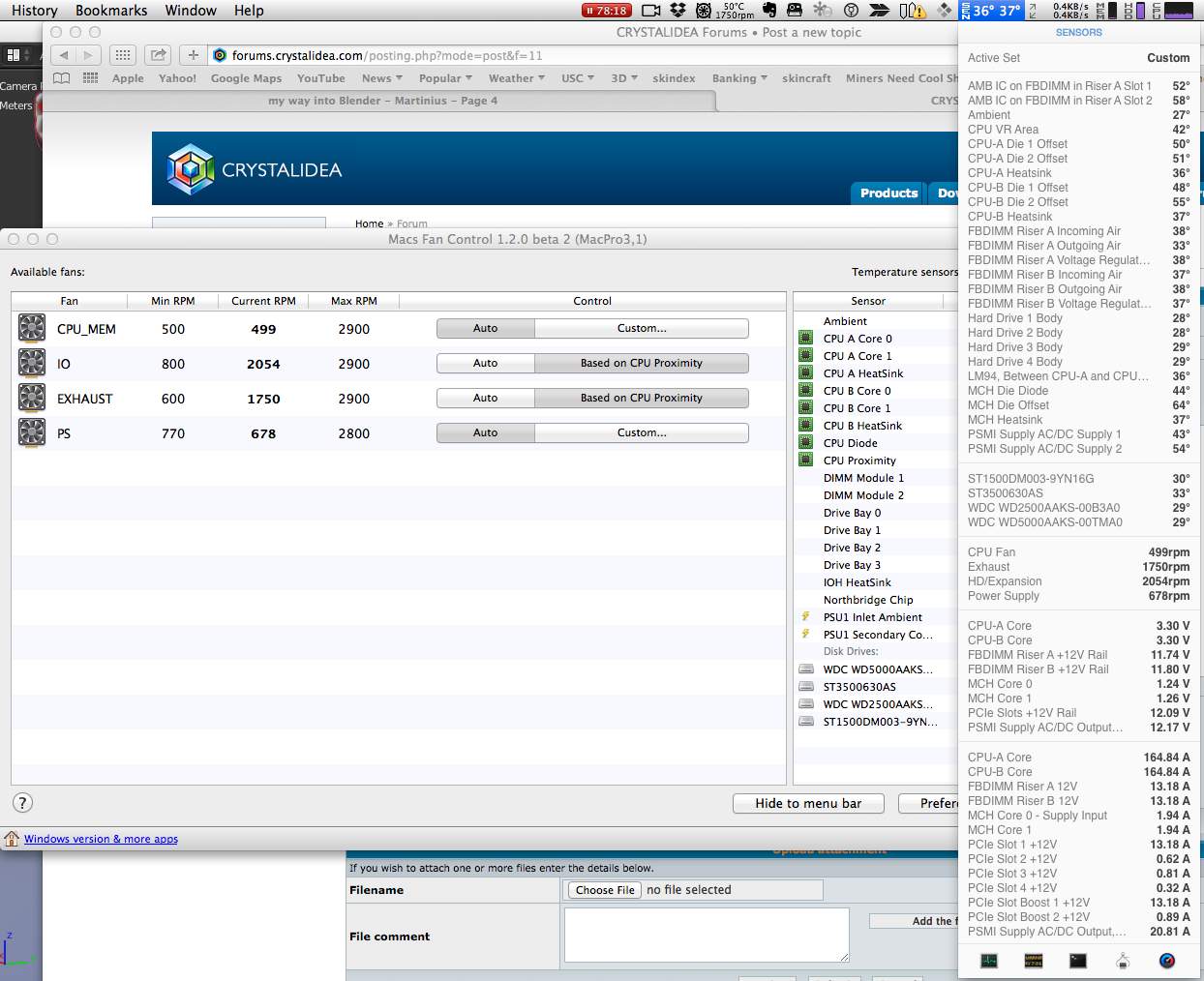

My 3,1 Mac Pro has been playing up lately, with exhaust and intake fans going full speed constantly.
After de-dusting, SMC reset, battery replacement the problem persisted. AHT reported a Voltage Sensor error on the CPU, and I was preparing myself for an inevitable logic board replacement when I could afford it.
Then I found Macs Fan Control. So far this is looking great, and gives me some quiet and sanity back. Here are my settings at the moment. Do you think this is a reasonable way to go, as far as choosing a sensor for these fans? (The screenshot was taken during some reasonably heavy 3d baking calculations, normally the fans are running closer to their minimums)
