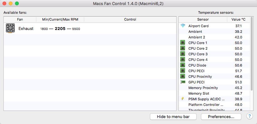

The 'control' section is missing in the new version.
Clicking in the blank area where the buttons should be has no effect.
Technical Info:
Macs Fan Control 1.4.0
Macmini6,2
Intel(R) Core(TM) i7-3720QM CPU @ 2.60GHz[105]
Mac OS X 10.11.3
Exhaust-min{1800}curr{2200}max{5500}mode{INVALID}
TA0P () - 38.625, 38.625
TA0p (Ambient) - 38.625, 38.625
TA1P () - 41.875, 41.875
TA1p (Ambient 2) - 41.875, 41.875
TC0C () - 49, 49
TC0D () - 49.875, 49.875
TC0E () - 50.3398, 50.3398
TC0F () - 52.3867, 52.3867
TC0G () - 99, 99
TC0J () - 2.04688, 2.04688
TC0P () - 46, 46
TC0c (CPU Core 1) - 49, 49
TC0d (CPU Diode) - 49.875, 49.875
TC0p (CPU Proximity) - 46, 46
TC1C () - 49, 49
TC1c (CPU Core 2) - 49, 49
TC2C () - 50, 50
TC2c (CPU Core 3) - 50, 50
TC3C () - 47, 47
TC3c (CPU Core 4) - 47, 47
TCGC () - 49, 49
TCGc (GPU PECI) - 49, 49
TCPG () - 103, 103
TCSC () - 47, 47
TCSc () - 47, 47
TCTD () - -1, 255.957
TCXC () - 50.0156, 50.0156
TCXc (CPU PECI) - 50.0156, 50.0156
TCXr () - -1, 201.016
TH0A () - 32.125, 32.125
TH0B () - -1, 129
TH0C () - -1, 129
TH0F () - -1, 204.125
TH0O () - 9, 9
TH0X () - -1, 204.125
TH0a () - 32.125, 32.125
TH0b () - -1, 129
TH0c () - -1, 129
TH1A () - -1, 129
TH1B () - -1, 129
TH1C () - -1, 129
TH1F () - -1, 0
TH1O () - -1, 249
TH1X () - -1, 129
TH1a () - -1, 129
TH1b () - -1, 129
TH1c () - -1, 129
TI0P () - 44.625, 44.625
TI0p (Thunderbolt Proximity) - 44.625, 44.625
TI1P () - 42.25, 42.25
TI1p () - 42.25, 42.25
TM0P () - 45.5, 45.5
TM0S (Memory Slot) - 48.9375, 48.9375
TM0p (Memory Proximity) - 45.5, 45.5
TMBS () - -1, 129
TP0P () - 46.125, 46.125
TP0p () - 46.125, 46.125
TPCD (Platform Controller Hub Die) - 48, 48
TW0P () - 36.875, 36.875
TW0p (Airport Card) - 36.875, 36.875
Tp0C (PSMI Supply AC/DC Supply 1) - 38.9336, 38.9336
Ts0G () - 49, 49
Ts0S () - 34.3164, 34.3164
APPLE SSD SM128E - 32.125
APPLE HDD HTS541010A9E662 - 30
Version 1.4.0 - Controls missing on Mac Mini 6,2 (OS X)
- screenshot
- missing control.png (56.94 KiB) Viewed 19811 times

Did you have previous version of the app installed? If yes, please run the following commands in Terminal:
killall MacsFanControl
rm ~/Library/Preferences/com.crystalidea.macsfancontrol.plist
killall -u `id -u -n` cfprefsd

Yes - I was running 1.3.3 before & had let it update.
Trashing the plist and restarting my cfprefsd sorted it out.

Could you please tell me which fan setting did you have before the update?

It was custom, based on cpu proximity

I have the exactly same problem with this post, i updated yesterday, and it start missing controls on the software.
I don't know how to solve it, please help. Btw, i am running it on windows 7

Please re-download the app!

I just reinstall it, problem solved, much appreciated!~
