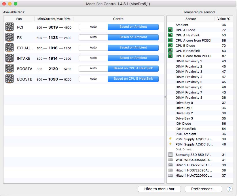

Just found your excellent app! One question: I have a 2012 Mac Pro upgraded to 2x3.46 GHZ, 6-core and 96 GB RAM. The custom control allows you to choose the sensor or ambient for control. Is there a recommended sensor for best avoidance of overheating for this Mac Pro?
Any info gratefully received.

Maybe I can answer with some logic. I hope somebody with more knowledge will come in.
I have a Mac Pro 4,1 hacked to 5,1 with twin processors and a couple of GPUs. I am currently running some scientific calculations which usually max out the processors and sometimes the GPU (GTX 980) so lots of heat! It seems to me that we basically have a heat energy balance - the processing puts in a certain amount of heat and there is nothing we can do to reduce that. It is ultimately no good changing heatsink grease etc as long as the heat sinks are getting hot. The only thing that will get the heat away is moving air through the heat sinks and out of the case.
Now it is simple physics to understand that the amount of heat energy that can be transferred will be proportional to the temperature difference. In other words, the hotter the heat sinks the better the transfer.
Having accepted this fact - I then did some experimenting. The most effective fans for controlling the processor heatsink temp is the relevant 'BOOST' fan. This is mounted in the heat sink so not surprising! I have thus set my Control to be based upon the relevant heat sink temperature. I have found that for continuous load, if I set the range 50 - 60degC then I keep the core below 100C. Dependant on the exact job in hand, they usually settle about 90C (A gets more abuse than B).
All the other fans are basically shifting air through the case so I have set them all to be based upon 'Ambient'. The coolest I ever see with the computer at rest is 30C and after a long period of max processing I can see it rise to 37-38C. I have thus set the range to 30-40C. This gives nice quiet fans for normal computer use but enough air flow to keep the balance for max processing.
The screen shot below shows the status quo whist the computer is full blast (after several hours) on a warmish day in UK. The room temp is about 28C. (edit - it refuses to paste the screen shot but the tech data is below)
I await any comments with interest.
Screen Shot 2017-08-25 at 18.01.20.jpg (101.54 KiB) Viewed 16152 times
You're welcome. Here is another attempt at adding the window.

So my question for others:
Is a 17/19degC difference between the CPU Diode and the CPU Heatsink typical (at prolonged full power) or could I reduce this with a new application of thermal grease?
To continue my thoughts from above - if the difference was smaller then the heatsink would be hotter and the heat transfer more efficient. Thus the CPU could be cooler for the same fan speeds.
I realise that I am thus disagreeing with my own previous statement about thermal grease!
