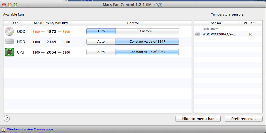

We don't know the reason for this problem, but this is the second report so far (for >3 years). the first report also happened on the same machine.
Maybe some sensor is broken (ODD cools down the GPU). If you discover the reason, please drop a line. Thanks
The 1st report looks like yours:
