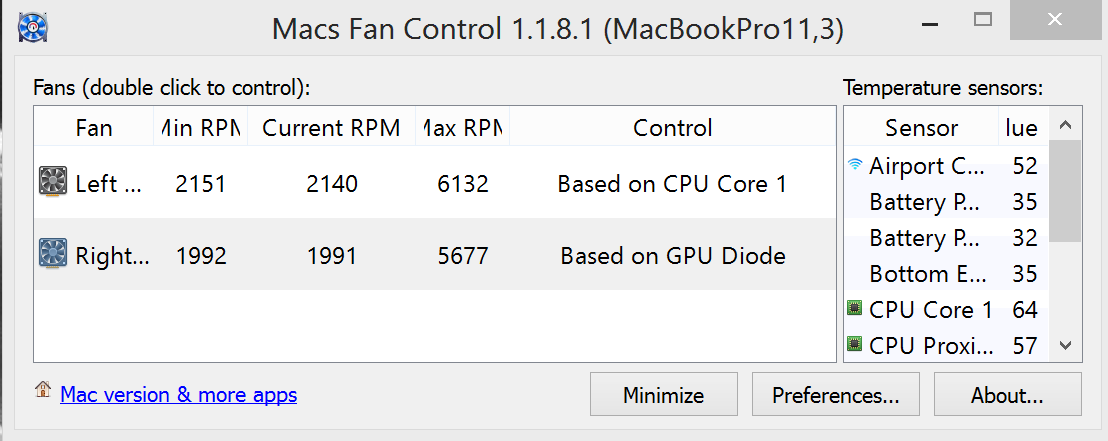

First of all: let me say this app is a great tool! It has solved a lot of heating problems with my Mac when I'm running Windows 8 in bootcamp.
However, there is an irritating bug: everytime I put windows 8 to hibernate, the app seems to crash, because when I get my mac out of sleep mode, the app is no longer open.
Also, when I click the button: copy technical info, I get the message: "Technical information is copied to the clipboard", but nothing is on my clipboard...
I'm using version 1.1.8.1 build 117
Can anybody help me?

- Screenshot main window
- Capture.PNG (41.65 KiB) Viewed 9122 times

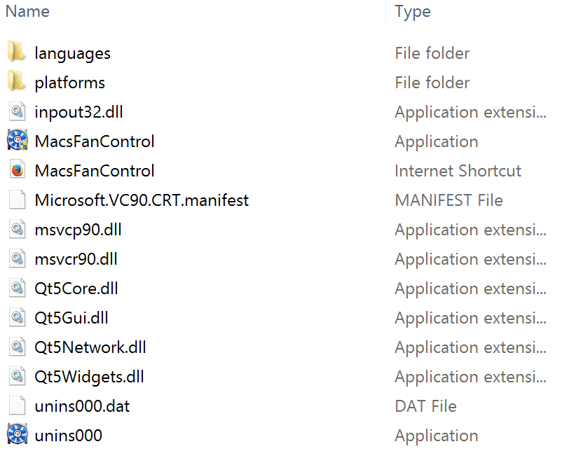

Would it be possible to provide me with a specific file name of the crash report please?
I suppose in my situation it should be located in: "C:\Program Files (x86)\Macs Fan Control".
All I seem to find are .dll, .exe and .manifest files?
- Capture.PNG (53.39 KiB) Viewed 9107 times
Re: Crash on WIN8 after reboot from standby
Ok, there's no crash report, but
