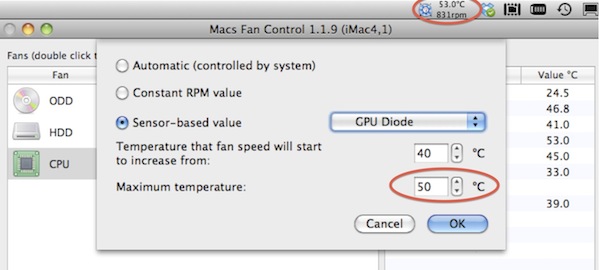

Now I updated to 1.1.9 and the fan doesn't react to the settings anymore.
I have the GPU temperature set to start cooling at 40 C and max at 50 C.
In the screenshot you can see these settings with the GPU temperature at 53 C and the fan at 831 rpm.
Any ideas or solutions?

Re: Doesn't work after update to 1.1.9
hekla
Hello.
CPU fan doesn't cool GPU. You should refer to ODD fan to cool down GPU.

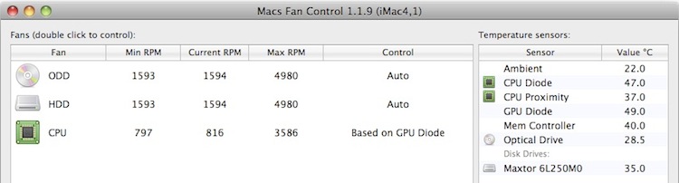

PS. Can you please give us: screenshot of the main window without any other windows?

Thank you for the quick answer.
Steven wrote:CPU fan doesn't cool GPU. You should refer to ODD fan to cool down GPU.
Ok, interesting, because it worked before ...
I tried with ODD – no difference.
And here is the screenshot:
