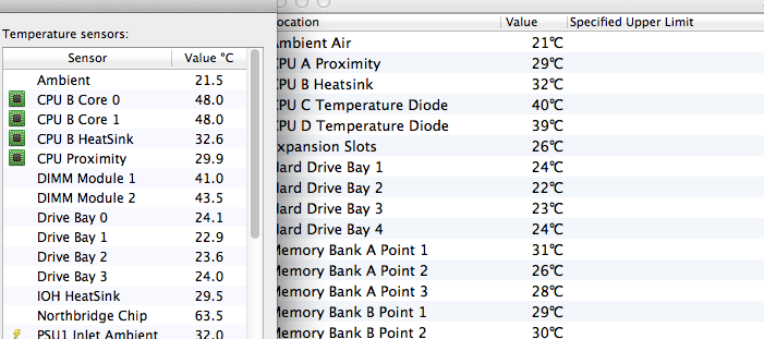

*EDITED* sorry guys, what i meant by backwards in the subject is, for example: as cpu temps rise, mac fan control reports them as cooler lol, then as the cpu cools mac fan control reports high temps.. So at idle, 63c(145.4f) is average, under load i see 32c(89.6f)... I hope that's a detailed enough explanation.
if i can offer anymore please ask :)
tech_info.txt
(1.09 KiB) Downloaded 1634 times
compare hardware monitor readings to mac fan control
Screen Shot 2014-04-04 at 10.15.41 AM.png (249.11 KiB) Viewed 13891 times

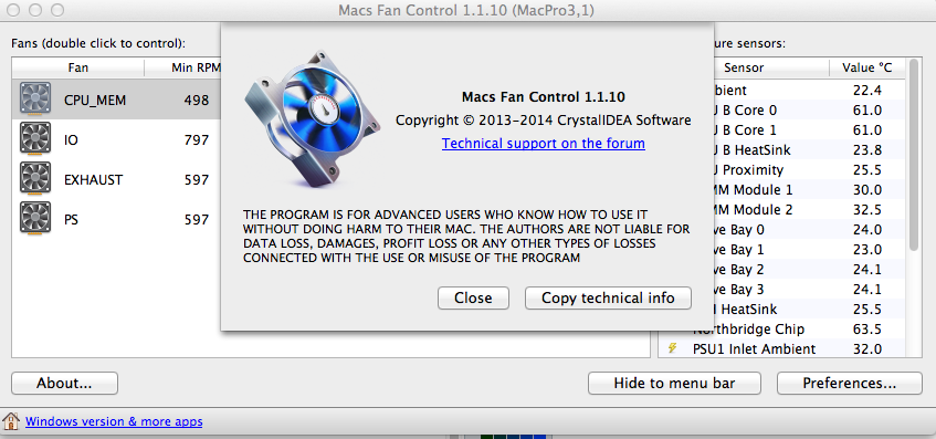

the about :)
the about :)
Screen Shot 2014-04-04 at 10.23.00 AM.png (124.14 KiB) Viewed 13891 times

Can you please tell me what's exactly odd here?
PS. Screenshot with hardware monitor is almost unreadable (low res)

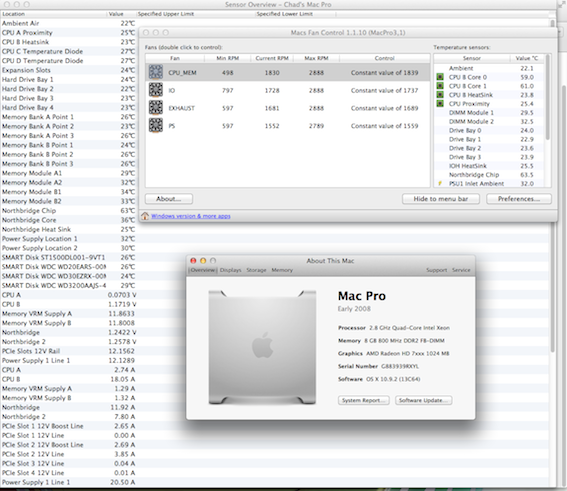

Absolutely sir, right now my cpu cores are reading 64c and 63c at idle in mac fan control
in Hardware monitor my readings are 26c and 26c
Ill put the system under load and let it go for a few minuites then post back with those readings..
so this is a base idle reading
Screen Shot 2014-04-04 at 10.39.26 AM.png (70.57 KiB) Viewed 13886 times
I really doubt it can be true. Too low for CPU

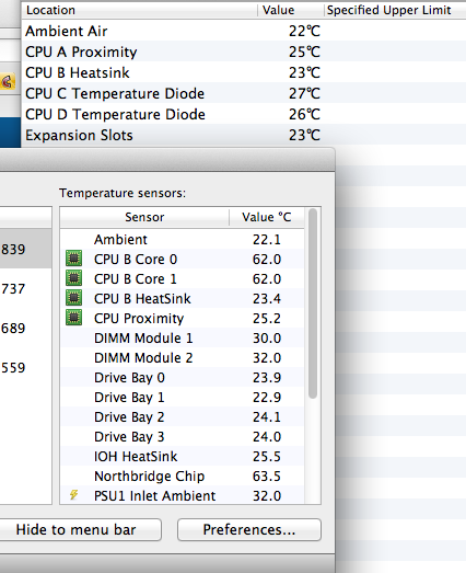

ok, under 100% load now
Screen Shot 2014-04-04 at 10.49.04 AM.png (88.33 KiB) Viewed 13885 times

see, so how come under load do the temps go backwards?
Re: Mac Pro 3.1 incorrect, backwards sensor readings
I don't know. But it's what we got... btw CPU B Heat sink matches..
My point is: is hardware monitor a 100% correct to trust? Do you have 4 CPUs? A B C D
Macs Fan Control reports here only T for CPU B mainly. Only CPU proximity stands for CPU A

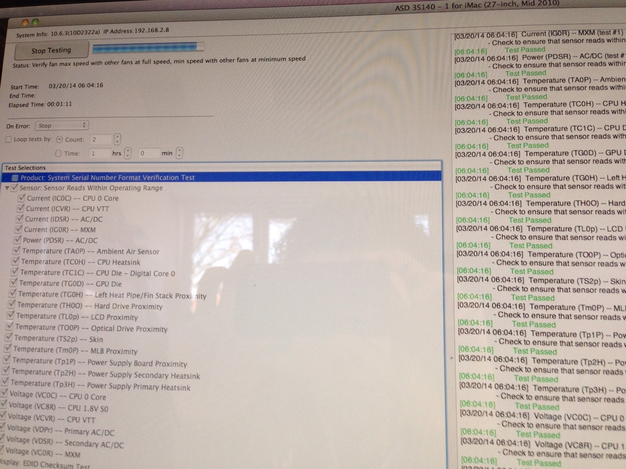

Yes. I'd be glad to see apple service diagnostic (when it tests sensors) photo. When it tests sensors, that would be a real help..
Example:
