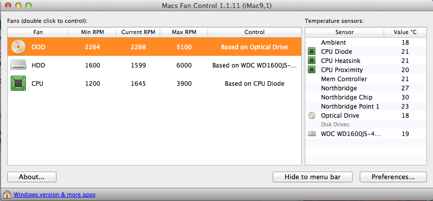

Yeah here's a screen shot. That is what it is at currently (2264) - after I had quit Macs Fan Control after startup and reopened it.
Upon start-up though it'llI have 5100 across the board for ODD.
I am pretty convinced it is an SMC Firmware problem too. Especially because two separate hard drives both had 5100 min rpm. Hopefully the next update may be able to fix this problem. If not, do you know what can be done other than resetting the SMC...is the SMC something that is an interchangeable part in the computer? Or a new ODD fan/cable?
Ultimately I can deal with it as long as I get lucky and the Min RPM is randomly set in the 2000's somewhere after reopening upon start-up.
- Screen Shot 2014-06-28 at 7.01.35 PM.png (74.22 KiB) Viewed 19065 times

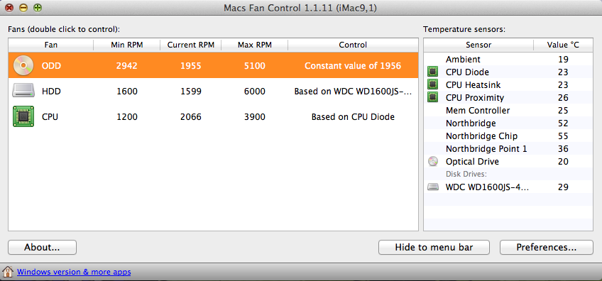

Also do you know if holding a fan's rpm at a constant value will cause the northbridge chip and almost everything to increase in temperature? If you look at this screen shot compared to the one above everything is hotter and my computer is doing nothing different.
I will try that and get back to you with results.
Once again thanks for all your help so far.
- Screen Shot 2014-07-02 at 6.51.09 PM.png (74.85 KiB) Viewed 19035 times
Re: ODD Fan Min RPM stuck at 5100 have tried everything
You have to play with settings yourself.
Generally ODD is not responsible for cooling CPU/Northbridge
