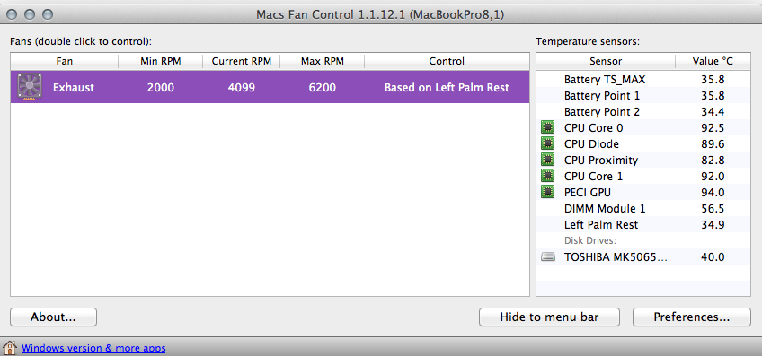

Based on that what would you set the settings to based on these options available from the attached screenshot?
Screen Shot 2014-08-05 at 15.34.40.png (72.6 KiB) Viewed 18971 times
Re: Optimal settings Macbook Pro (8,1)
Posted: 05 Aug 2014, 14:49
steveyeu
100 is max for your CPU, as I've said.
Correlation to Left Palm Rest is definetely not correct.
Try experimenting, maybe Automatic control will be fine for most of the cases.
