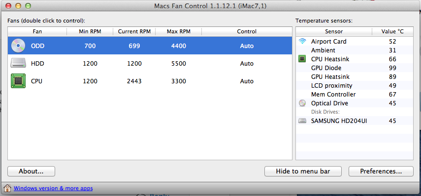

I've removed temperature monitor, reset the fans to auto and reset the SMC one more time. However, I think you can see from my screenshot the problem. With Automatic fan control, the temperature of my GPU Diode is nearly 100 Celsius, which seems way too hot. These temperatures are not from gaming, but just normal web browsing. If I try to play a 3d game, the temperature can hit 130 Celsius. I have to keep the fans cranked higher, otherwise I'm afraid my GPU will melt. Any other suggestions?

Re: iMac keeps needing SMC resets, won't sleep
jhelzei
what about sleep/restart issue now?
PS. try to set constant 2000-2500 RPM value to ODD fan

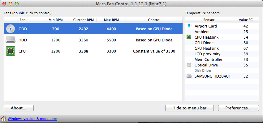

So far I haven't needed to reset the SMC. :good: However, sleep continues to be a problem. Setting the ODD fan to 2400 rpm didn't keep it cool enough, so I've set both ODD and HDD fans back to GPU Diode controlled and the CPU fan to 3300 rpm. Should I avoid controlling fan speed with another sensor, or just use constant rpms?
Try setting all fans to auto and check the sleep issue.
