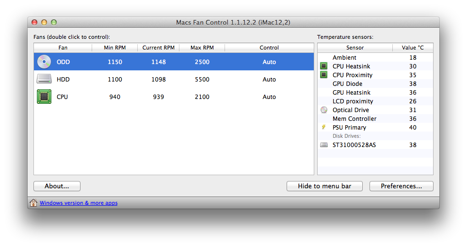

I had the previous version installed and upgraded to Macs Fan Control 1.1.12.2, since then I can no longer see and select all of the sensors for my Mid 2011 iMac 21.5" (see attached screenshot). I'm running MacOS 10.9.4
Obviously in this instance for the CPU I would like to select either the cpu or it's heat sink sensor.

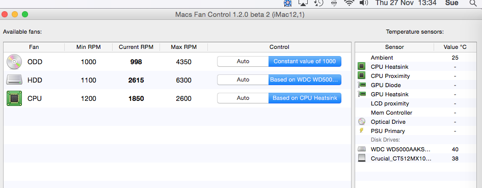

Still having problems. We have multiple user accounts on this iMac and need to have a copy of Macs Fan Control in the startup items for each user as there seems to be no way to make it a system wide startup process.
One user, not the administrator, can see all of the sensors in her copy of MFC whereas I cannot. Screenshots attached - obviously I would like to set the CPU fan using a CPU sensor, any ideas?

Sorry for the late reply, the sensors seem to be recognised sometimes and sometimes not. At the moment, the CPU sensor is not being seen by the OSX or the W7 client. This causes the fan to run at full speed.
