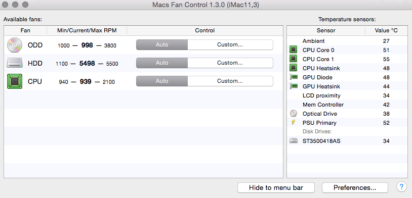

No crash reports. If I don't force quit it, it never terminates. No crash log. Just beachball of doom.

- Screen Shot 2015-06-22 at 10.39.15 AM.png (74.92 KiB) Viewed 32659 times

As mentioned above, as soon as I change the hard drive setting, the app locks up. The windows stays visible but goes 'Not Responding'. If I reboot, it launches, the icon shows up in the menubar, but if you mouse over it, beachball. Try to click on it, it does nothing. If I force quit it through the Activity Monitor and try to restart the app, it does same thing.
If I force quit it, go in and delete the Preference file, and try to reopen it before reboot, it just hangs. You check the folder, and the preference file is there.
To get it to relaunch so I could provide screenshots, I have to delete the Preference file, reboot the computer, relaunch Macs Fan Control and it will come up.
It worked with 1.2.x version; As soon as I upgraded to 1.3.0, this started it. I've tried deleting the preference file and 1.3.0 MFC, rebooting and then reinstalling the older 1.2.x version of Macs Fan Control, but that doesn't work.
Question; Besides in ~/Library/Preferences, does MFC save anything elsewhere that I could try deleting?

As soon as I turned the log on, after wiping the Pref file and rebooting, it beachballs on startup now. Where is the log stored?
Attached is the video. Please note that the video doesn't show the beachball, but it happens as soon as I click 'Ok'

Even by me just setting the 'Enable Logging' preference, it locks up on the restart (Not immediately.)
It does hang on a constant RPM value as well.
It actually hangs with setting the ODD and CPU to constant or sensor as well. It almost seems like as soon as the preference file is made, it goes under unless it is the default settings file (Nothing changed.)
Edit: Your command-line thing at least prevents me needing to reboot each time to test.

INFO 2015-06-28T11:23:59.543 MacFanControl/core/FanControl.cpp @ 82 "Fan " 0 ": auto"
INFO 2015-06-28T11:23:59.543 MacFanControl/core/FanControl.cpp @ 82 "Fan " 1 ": auto"
INFO 2015-06-28T11:23:59.543 MacFanControl/core/FanControl.cpp @ 82 "Fan " 2 ": auto"
INFO 2015-06-28T11:23:59.543 MacFanControl/core/FanControl.cpp @ 345 "QFanControl::Init - QTempSensorSmart::loadAvailableSensors"
INFO 2015-06-28T11:23:59.546 MacFanControl/core/FanControl.cpp @ 349 "QFanControl::Init: number of supported SMC sensors: 10"
INFO 2015-06-28T11:23:59.546 MacFanControl/core/FanControl.cpp @ 350 "QFanControl::Init: number of supported SMART sensors: 1"
INFO 2015-06-28T11:24:57.206 MacFanControl/app.cpp @ 158 "Macs Fan Control 1.3.0"
INFO 2015-06-28T11:24:57.206 MacFanControl/app.cpp @ 159 "Mac OS X Unknown"
INFO 2015-06-28T11:24:57.207 MacFanControl/app.cpp @ 160 "iMac11,3"
INFO 2015-06-28T11:24:57.207 MacFanControl/app.cpp @ 161 "Intel(R) Core(TM) i3 CPU 550 @ 3.20GHz"
INFO 2015-06-28T11:24:57.207 MacFanControl/app.cpp @ 162 "Qt 5.4.1"
INFO 2015-06-28T11:24:57.803 MacFanControl/core/FanControl.cpp @ 318 "QFanControl::Init"
INFO 2015-06-28T11:24:57.803 MacFanControl/core/FanControl.cpp @ 332 "QFanControl::Init - LoadCachedFansAndTempSensors"
INFO 2015-06-28T11:24:57.804 MacFanControl/core/FanControl.cpp @ 337 "QFanControl::Init - FilterSupportedTempSensors"
WARN 2015-06-28T11:24:57.812 MacFanControl/core/smc.cpp @ 366 "smc_get_temp - skipping sensor TC0D with value of 129"
WARN 2015-06-28T11:24:57.812 MacFanControl/core/FanControl.cpp @ 225 "FilterSupportedTempSensors - skipping sensor TC0D with value of -1"
WARN 2015-06-28T11:24:57.817 MacFanControl/core/smc.cpp @ 366 "smc_get_temp - skipping sensor TC0P with value of 129"
WARN 2015-06-28T11:24:57.817 MacFanControl/core/FanControl.cpp @ 225 "FilterSupportedTempSensors - skipping sensor TC0P with value of -1"
INFO 2015-06-28T11:24:57.836 MacFanControl/core/FanControl.cpp @ 341 "QFanControl::Init - smc_get_fans_control_mode"
INFO 2015-06-28T11:24:57.838 MacFanControl/core/FanControl.cpp @ 82 "Fan " 0 ": auto"
INFO 2015-06-28T11:24:57.838 MacFanControl/core/FanControl.cpp @ 82 "Fan " 1 ": auto"
INFO 2015-06-28T11:24:57.838 MacFanControl/core/FanControl.cpp @ 82 "Fan " 2 ": auto"
INFO 2015-06-28T11:24:57.838 MacFanControl/core/FanControl.cpp @ 345 "QFanControl::Init - QTempSensorSmart::loadAvailableSensors"
INFO 2015-06-28T11:24:57.874 MacFanControl/core/FanControl.cpp @ 349 "QFanControl::Init: number of supported SMC sensors: 10"
INFO 2015-06-28T11:24:57.874 MacFanControl/core/FanControl.cpp @ 350 "QFanControl::Init: number of supported SMART sensors: 1"
INFO 2015-06-28T10:47:44.846 MacFanControl/app.cpp @ 159 "Mac OS X Unknown"
INFO 2015-06-28T10:47:44.846 MacFanControl/app.cpp @ 160 "iMac11,3"
INFO 2015-06-28T10:47:44.862 MacFanControl/app.cpp @ 161 "Intel(R) Core(TM) i3 CPU 550 @ 3.20GHz"
INFO 2015-06-28T10:47:44.862 MacFanControl/app.cpp @ 162 "Qt 5.4.1"
INFO 2015-06-28T10:47:45.370 MacFanControl/core/FanControl.cpp @ 318 "QFanControl::Init"
INFO 2015-06-28T10:47:45.370 MacFanControl/core/FanControl.cpp @ 332 "QFanControl::Init - LoadCachedFansAndTempSensors"
INFO 2015-06-28T10:47:45.371 MacFanControl/core/FanControl.cpp @ 337 "QFanControl::Init - FilterSupportedTempSensors"
WARN 2015-06-28T10:47:45.380 MacFanControl/core/smc.cpp @ 366 "smc_get_temp - skipping sensor TC0D with value of 129"
WARN 2015-06-28T10:47:45.380 MacFanControl/core/FanControl.cpp @ 225 "FilterSupportedTempSensors - skipping sensor TC0D with value of -1"
WARN 2015-06-28T10:47:45.385 MacFanControl/core/smc.cpp @ 366 "smc_get_temp - skipping sensor TC0P with value of 129"
WARN 2015-06-28T10:47:45.385 MacFanControl/core/FanControl.cpp @ 225 "FilterSupportedTempSensors - skipping sensor TC0P with value of -1"
INFO 2015-06-28T10:47:45.407 MacFanControl/core/FanControl.cpp @ 341 "QFanControl::Init - smc_get_fans_control_mode"
INFO 2015-06-28T10:47:45.411 MacFanControl/core/FanControl.cpp @ 82 "Fan " 0 ": auto"
INFO 2015-06-28T10:47:45.411 MacFanControl/core/FanControl.cpp @ 82 "Fan " 1 ": auto"
INFO 2015-06-28T10:47:45.411 MacFanControl/core/FanControl.cpp @ 82 "Fan " 2 ": auto"
INFO 2015-06-28T10:47:45.411 MacFanControl/core/FanControl.cpp @ 345 "QFanControl::Init - QTempSensorSmart::loadAvailableSensors"
INFO 2015-06-28T10:47:45.414 MacFanControl/core/FanControl.cpp @ 349 "QFanControl::Init: number of supported SMC sensors: 10"
INFO 2015-06-28T10:47:45.414 MacFanControl/core/FanControl.cpp @ 350 "QFanControl::Init: number of supported SMART sensors: 1"
INFO 2015-06-28T11:23:58.934 MacFanControl/app.cpp @ 158 "Macs Fan Control 1.3.0"
INFO 2015-06-28T11:23:58.934 MacFanControl/app.cpp @ 159 "Mac OS X Unknown"
INFO 2015-06-28T11:23:58.934 MacFanControl/app.cpp @ 160 "iMac11,3"
INFO 2015-06-28T11:23:58.939 MacFanControl/app.cpp @ 161 "Intel(R) Core(TM) i3 CPU 550 @ 3.20GHz"
INFO 2015-06-28T11:23:58.939 MacFanControl/app.cpp @ 162 "Qt 5.4.1"
INFO 2015-06-28T11:23:59.507 MacFanControl/core/FanControl.cpp @ 318 "QFanControl::Init"
INFO 2015-06-28T11:23:59.507 MacFanControl/core/FanControl.cpp @ 332 "QFanControl::Init - LoadCachedFansAndTempSensors"
INFO 2015-06-28T11:23:59.508 MacFanControl/core/FanControl.cpp @ 337 "QFanControl::Init - FilterSupportedTempSensors"
WARN 2015-06-28T11:23:59.515 MacFanControl/core/smc.cpp @ 366 "smc_get_temp - skipping sensor TC0D with value of 129"
WARN 2015-06-28T11:23:59.515 MacFanControl/core/FanControl.cpp @ 225 "FilterSupportedTempSensors - skipping sensor TC0D with value of -1"
WARN 2015-06-28T11:23:59.520 MacFanControl/core/smc.cpp @ 366 "smc_get_temp - skipping sensor TC0P with value of 129"
WARN 2015-06-28T11:23:59.520 MacFanControl/core/FanControl.cpp @ 225 "FilterSupportedTempSensors - skipping sensor TC0P with value of -1"
INFO 2015-06-28T11:23:59.540 MacFanControl/core/FanControl.cpp @ 341 "QFanControl::Init - smc_get_fans_control_mode"

1. Has the app ever worked fine on this mac?
2. Try to delete this file and tell me if the app still hangs: Macs Fan Control.app\Contents\Resources\smc-write
Hey. Sorry for the late reply.
bladedthoth
- Posts: 11
- Joined: 17 Jun 2015, 19:55
Re: The app hangs when changing fan control
#1: Yes. Worked fine prior to a reinstall of OS X. Worked fine after a reinstall. Wasn't until I installed the update 1.3.0 that it stopped working.
- I reinstalled because Yosemite was running so slow for me. Reinstall helped with speed.
#2: Deleted the smc-write file from inside the .app. Still hangs on change.
bladedthoth, would you test the special debug version with verbose logging/messages?
bladedthoth
- Posts: 11
Sure! I'd love to.
bladedthoth
http://www.crystalidea.com/downloads/ma ... ol_dbg.zip
This version will product exactly 7 messages (numerated) after you try to modify fan speed.
If the app will hang, the will be less messages.
PS. Not log messages, but directly in the app window.
