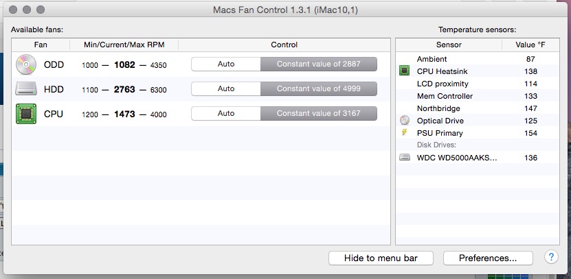

I find that my 2009 iMac runs hot to the touch, and on days when the ambient temperature is hot, I'd rather the machine run cooler, even if that means louder fans. I've installed Macs Fan Control, and I can see readings for temperature on many sensors, and RPM on three fans, but nothing I do changes the speed of the fans. I've tried multiple restarts, I've reset the SMC and the NVRAM and those didn't help.
Any ideas on what I might be doing incorrectly?
Macs Fan Control 1.3.1
iMac10,1
Intel(R) Core(TM)2 Duo CPU E7600 @ 3.06GHz[100]
Mac OS X 10.10
ODD-min{1000}curr{1076}max{4350}mode{1,2887}
HDD-min{1100}curr{2771}max{6300}mode{1,4999}
CPU-min{1200}curr{1509}max{4000}mode{1,3167}
TA0P (Ambient) - 30.2578, 30.2578
TA0p () - 33.875, 33.875
TC0C (CPU Core 0) - -1, 129
TC0D (CPU Diode) - -1, 129
TC0H (CPU Heatsink) - 59.125, 59.125
TG0D (GPU Diode) - -1, 129
TG0H (GPU Heatsink) - -1, 129
TG0p () - -1, 129
TH0O () - 7, 7
TH1O () - 7, 7
TL0P (LCD proximity) - 45.7422, 45.7422
TL0V () - 46.7578, 46.7578
TL0p () - 57.875, 57.875
TL1V () - 49.3594, 49.3594
TL2V () - 51.4102, 51.4102
TLAV () - 51.4102, 51.4102
TLBV () - 49.8164, 49.8164
TLCV () - 46.7578, 46.7578
TN0D (Northbridge Chip) - -1, 129
TN0H (Northbridge) - 63.75, 63.75
TN0P (Northbridge Point 1) - -1, 129
TO0P (Optical Drive) - 51.875, 51.875
TO0p () - 52.875, 52.875
TS0V () - 48.5625, 48.5625
TS2V () - 51.8828, 51.8828
Tm0P (Mem Controller) - 56.5, 56.5
Tm0p () - 56.5, 56.5
Tp1P () - 64.75, 64.75
Tp2H () - 72.25, 72.25
Tp3H (PSU Primary) - 67.5, 67.5
Tp3v () - -1, 0
WDC WD5000AAKS-40V2B0 - 58
Screen Shot 2015-09-21 at 1.33.03 AM.jpg (71.45 KiB) Viewed 11191 times
Re: Temp readings and RPM readings, but can't change fan speed
knewman
ODD - it changed to 1082 instead of 2887
HDD - it changed to 1763 instead of 5000
CPU - it changed to 1473 instead of 3167
right?
