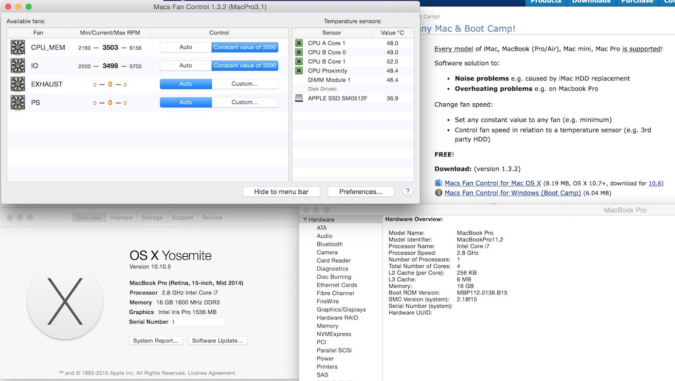

Hopefully someone can help me fix this... for some reason the fan control application sees my MacBookPro Mid-2014 as a Mac Pro 2008 model.
Is there some preference file I can adjust to change the detected hardware by this?

We're aware of this issue, it will be fixed in the next update.
Current workaround is:
#!/bin/bash
killall MacsFanControl
rm ~/Library/Preferences/com.crystalidea.macsfancontrol.plist
killall -u `id -u -n` cfprefsd

Thanks Steven, that worked.

Fixed in 1.4
