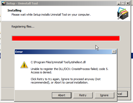

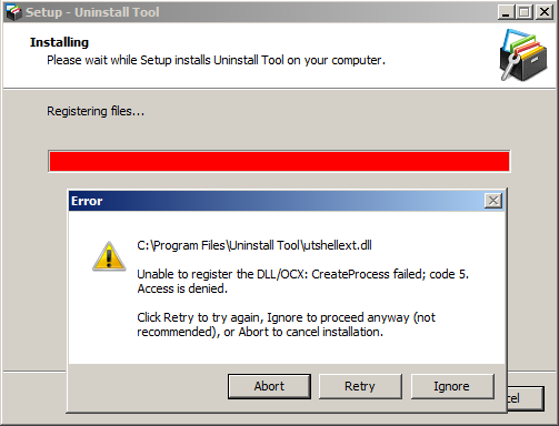

Re: Unable to install new Uninstall Tool 3.4.4

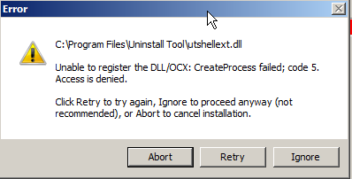

Thanks for you suggestion, but after the install process I am getting the same error message. I am attaching a screenshot of the error message to see if that will help you more. I really would like to use this software I paid for.
Also, since I had to uninstall I thought maybe removing all the traced data would help, but this did not do anything in terms of me trying to reinstall the software. I am still getting the same error.
In a future edition of this software, will it be possible to export or save this "traced data" for any future problems like this? It would be nice to be able to backup the traced data in case of any install upgrade issues like I am having. Right now, I lost all my traced data since I was not sure if this should be removed during the use of the Uninstall exe you suggested.
Thanks.
Thanks.

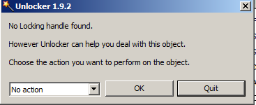

Fixitmad
Please try thes free Unlocker app to unlock the file
Install it and do the right click on the file to unlock it or schedule removal on the PC reboot.
Direct download link: http://www.emptyloop.com/unlocker/Unlocker1.9.2.exe
More info about Unlocker: http://emptyloop.com/unlocker/
C:\Program Files\Uninstall Tool\utshellext.dllDirect download link: http://www.emptyloop.com/unlocker/Unlocker1.9.2.exe
When uninstalling the app (Uninstall Tool), traced apps information is not removed. The uninstaller asks if you want to keep this data.
Yes, I also have that tool already installed and it indicates that no locking handle found for utshellext.dll. If I delete it, the install still cannot proceed. If I remove it during reboot, I still get the same error message.
During the previous uninstall process I already told the software to remove the traced apps and I said Yes thinking maybe this would help the software install.
Is there something else I can try? Is there a reason why this dll is not registering during the install process?

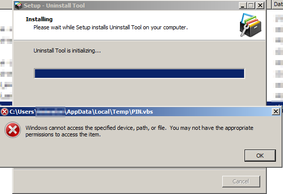

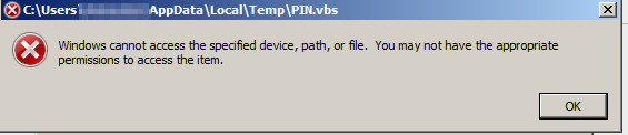

If I tell the software to ignore the dll not registering I get this strange message about a pin.vbs file.
The software does not work properly. I really really need to get this software working again since I find its use invaluable.
I should mention that I have Administrator rights so I do not know why I am having these issues. I am able to install other software fine.
Thanks.
Thanks.
- 2015-12-28 20_07_29-CRYSTALIDEA Forums • View topic - Unable to install new Uninstall Tool 3.4.4.png (9.28 KiB) Viewed 466417 times

1. Are you sure you're using the official installer?
http://www.crystalidea.com/downloads/un ... _setup.exe
I'm asking because we never included PIN.vbs in our app.
2. What is your Windows version?
Steven,
I tried to install Uninstall Tool 3.4.4 using the link you provided and I still get that PIN.VBS window when I select the Ignore option during the Unable to register DLL/OCX. Error 5 code.
I have attached a screenshot of this install. It appears the pin.vbs is still included with this installer.
I still cannot use this software I Paid for.
Looking at the Pin.vbs file, this is what it contains:
Set objShell = CreateObject("Shell.Application")
Dim path
path=ChrW(67) + ChrW(58) + ChrW(92) + ChrW(80) + ChrW(114) + ChrW(111) + ChrW(103) + ChrW(114) + ChrW(97) + ChrW(109) + ChrW(32) + ChrW(70) + ChrW(105) + ChrW(108) + ChrW(101) + ChrW(115) + ChrW(92) + ChrW(85) + ChrW(110) + ChrW(105) + ChrW(110) + ChrW(115) + ChrW(116) + ChrW(97) + ChrW(108) + ChrW(108) + ChrW(32) + ChrW(84) + ChrW(111) + ChrW(111) + ChrW(108) + ChrW(92)
Dim lnk
lnk=ChrW(85) + ChrW(110) + ChrW(105) + ChrW(110) + ChrW(115) + ChrW(116) + ChrW(1072) + ChrW(108) + ChrW(108) + ChrW(32) + ChrW(84) + ChrW(111) + ChrW(111) + ChrW(108) + ChrW(46) + ChrW(108) + ChrW(110) + ChrW(107)
Dim verb
verb=ChrW(80) + ChrW(105) + ChrW(110) + ChrW(32) + ChrW(116) + ChrW(111) + ChrW(32) + ChrW(83) + ChrW(116) + ChrW(97) + ChrW(114) + ChrW(116) + ChrW(32) + ChrW(77) + ChrW(101) + ChrW(110) + ChrW(38) + ChrW(117)
Set objFolder = objShell.Namespace(path)
Set objFolderItem = objFolder.ParseName(lnk)
Set colVerbs = objFolderItem.Verbs
For Each objVerb in colVerbs
If objVerb.name = verb Then
objVerb.DoIt
Exit For
End If
Next
Dim path
Dim lnk
Dim verb
objVerb.DoIt
Exit For
End If
Next
- 2016-01-14 19_59_22-Program Manager.png (49.85 KiB) Viewed 466253 times
Fixitmad
Thank you.
I've located the problem in the app, will do the fix right away.
Thank you.

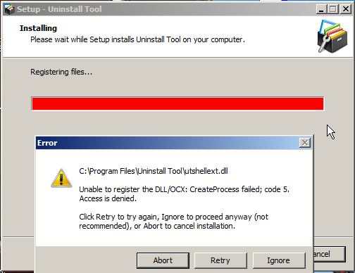

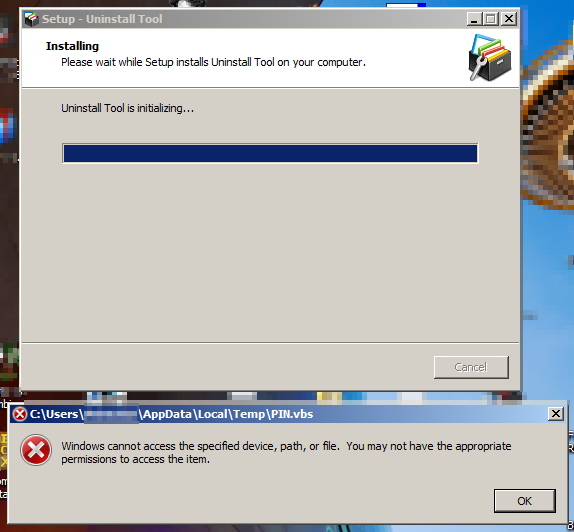

I tried again and still getting the same errors. Something new, at the end if I select Ignore I still get the Pin.vbs error and the program will not run when the option to run Uninstall Tool is selected.
It seems the install is acting the same.
Thanks.
Thanks.
- 2016-01-18 17_47_09-12062015.png (21.23 KiB) Viewed 466176 times
- 2016-01-18 17_46_45-Setup - Uninstall Tool.png (19.57 KiB) Viewed 466176 times
- 2016-01-18 17_46_27-12062015.png (20.36 KiB) Viewed 466176 times
Hello Steven,
I downloaded the Developer version again and tried to install it and still received the same messages as before.
Fixitmad
Looks like these errors are caused when running the setup under non-admin account. Can you make sure you launch uninstalltool_setup.exe under administrator account?
