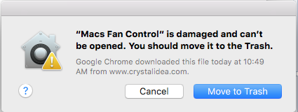

Macs Fan Control Version = 1.4.2
OSX Version = 10.11.5 (15F31a)
App Damaged & Can't Be Opened
- When you try to launch Macs Fan Control OSX gives you this message. You can cancel or delete.
- Screenshot 2016-05-05 11.02.10.png (33.38 KiB) Viewed 21033 times

Re: App Damaged & Can't Be Opened
Yes but the last version of your software worked fine with this 10.11.5 beta.
It doesn't work for me. As soon as I updated to 10.11.5, Macs Fan Control stopped working. It would even open. And when I re-download it, I get the same error as the O.P.
My fans are on full-blast as I type this and Macs Fan Control will no longer install.

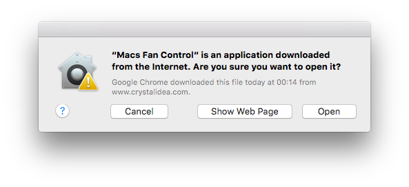

utarasone
Which version works for you?
https://github.com/crystalidea/macs-fan ... l/releases
Just tried to run the app on my 2 macs on 10.11.5, in both cases I get this:
- Screen Shot 2016-05-21 at 00.14.41.png (45.46 KiB) Viewed 20981 times
For those with the same issue:
Okay, I got it to work. In order to do so, I needed to go into System Preferences>Security & Privacy>General and choose "Anywhere" under the "Allow apps downloaded from:" section. This is why the application wouldn't install and would give the warning that the original poster took the screen-shot of.
The update to 10.11.5 caused this reset for me. After you allow Macs Fan Control to be installed and be opened, you can change the security preference back to only allowing applications to be downloaded by "Mac App Store (and identified developers)" if you prefer.
utarasone
The "Damaged & Can't Be Opened" error appears if the digital signature of the app is wrong. The digital signature of Macs Fan Control is OK. The provided workaround works, but anyway it's very strange for me (no idea at the moment).
