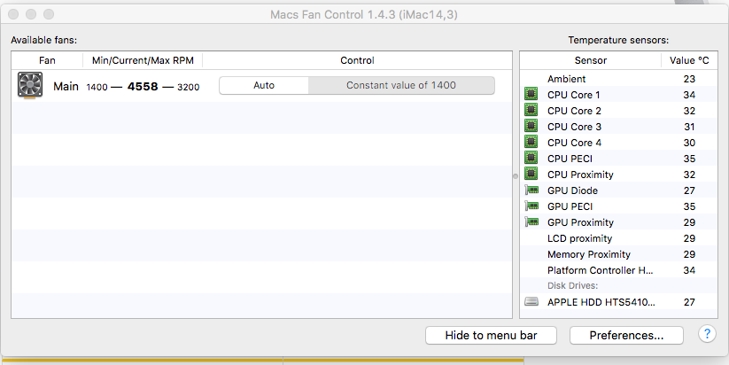

there it is
- Bildschirmfoto 2016-07-18 um 14.22.11.png (67.96 KiB) Viewed 19735 times

It's always spinning at ~4500 RPM ?
mariahcarey
- Posts: 5
- Joined: 18 Jul 2016, 12:04
Re: something is wrong - min/max fan values are equal
yes! well, at least almost always. sometimes it gets into phases where it acts completely normal, but then for hours, 4500 rpm...
It's definitely not normal, moreover temperatures are very low, looks like something is broken.
1. Make sure you have the latest version of SMC :
https://support.apple.com/kb/DL1699
2. Try to test the app on Windows (Boot Camp). If the situation is the same - i suspect some physical damage to mac internals (fan controller or wire)
