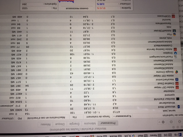

I have exactly the same issue. I installed MFC yesterday, because the fans at my MBP 15" 2015, Radeon R9 M370X, were quite annoying, especially when looking to flash- and html5 videos on the web.
Today I recognized a sudden slowdown of the system (OSX 10.11.6) and a kernel_task CPU activity of about 500% in average and 780% peak. I had to deselect MFC autostart option, quit MFC, shut down the computer for 5 min with power cable detached and reboot - then it workd again correctly.
- Screenshot Activity monitor
- image1.JPG (109.73 KiB) Viewed 46503 times

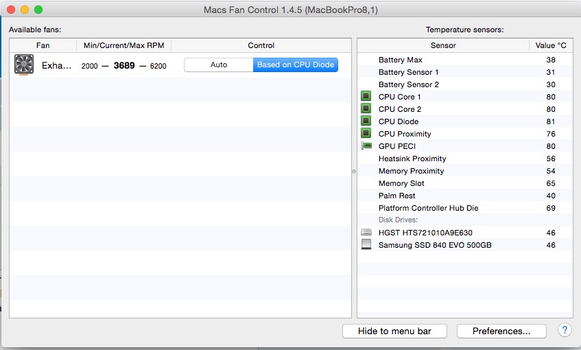

Re: Manually setting fan speed makes kernel_task eats all my CPU
I have this problem consistently. Setting MFC to Custom Control (measuring temp on CPU Diode, fan increasing from 65C to a max of 99C with min fan at 2000 and max fan at 6200) consistently results in kernel_task starting to take upwards of 200% of CPU and slowing down the machine to the point that it become unusable. Setting MFC back to automatic gets kernel_task back to something more reasonable.
The thing is: it takes a while for the kernel_task problem to appear. But it does so consistently.
Screenshot:
Technical info:
Macs Fan Control 1.4.5
MacBookPro8,1
CPU: Intel(R) Core(TM) i5-2435M CPU @ 2.40GHz [100]
GPU: Intel HD Graphics 3000
macOS 10.10.5
Exhaust-min{2000}curr{4006}max{6200}mode{2,TC0D,65,99}
Screenshot:
Technical info:
