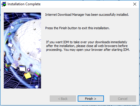

I ran the installer and proceeded as usual while monitoring it with the Install Tracker. When installer finished copying files, it prompted following window:
Up until now, everything was fine. But when I pressed finish, the installer created a service called IDMWFP and launched two background processes (i.e. IDman.exe and IEMonitor.exe) without asking. Then the Install Tracker stopped monitoring and save button became active even though these two child processes were still running.
The problem here is that the installer launches the Internet Download Manager (IDMan.exe) for the first time without asking the user, and Install Tracker is unable to monitor it. Install Tracker thinks every child processes are finished but it is not the case here. I know that most of the programs do make changes to the system when they are run for the first time. I am pretty sure that IDMan.exe created a lot of registry and folder entries which was missed by the Install Tracker.

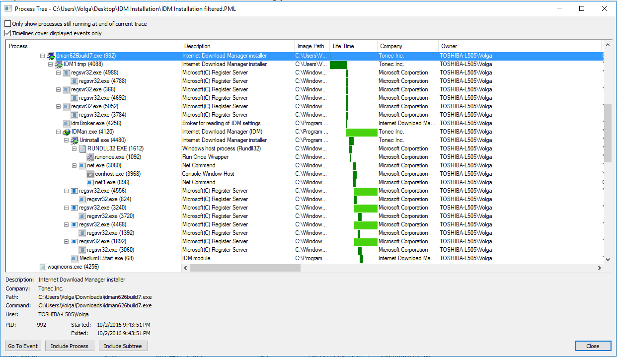

Later, I removed the Internet Download Manager and reinstalled it while monitoring the system changes with ProcMon from Sysinternals. After installation, I filtered the system changes to include only the installer and its child processes. I realized that the installer runs regsvr32.exe and many other processes many times. Here the process tree from ProcMon captured from beginning to the end of the installation:
These processes make many changes to the system which Install Tracker misses. I can see that by comparing registry and folder changes in the Uninstall Tool's XML file and ProcMon's filtered PML file. I am including monitoring results from ProcMon and Uninstall Tool in IDM Installation.rar file in the attachment.

You are right that two background processes (IDMan.exe and IEMonitor.exe) are somehow created by system processes and therefore Install tracker misses them. However ProcMon can classify these processes as child processes of the installer executable. (idman626build7.exe see the screenshot of the process tree)
If ProcMon can do that safely. (it is obvious that IDman is related to Internet Download Manager), how come Uninstall Tool can not ?
Thank you.
