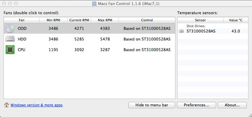

Re: Mavericks
Ok here it is...
Right now it reads 43, I put it with the sensor option to allow the max to be 45c
It's only at this temp cuz I had shut the screen off and did some things and just returned.
- iMac7,1err.jpg (58.52 KiB) Viewed 24350 times

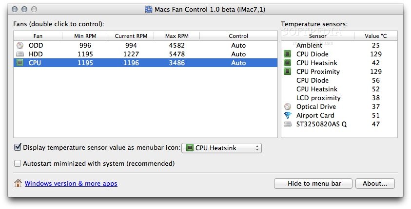

Re: Mavericks
1. All 3 fans mustn't be assigned to a single sensor (HDD)
2. I do suspect an error in SMC layer of your mac - there're no temperature sensors at all! Try to reset SMC. This iMac is supported by MFC, see picture.
- iMac7,1.jpg (66.49 KiB) Viewed 24350 times
