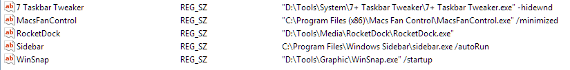

I did have some problems getting the app to autostart in Windows - after disabling UAC it now autostarts, but not minimized; I have to manually minimize. Is this only me?

Hello and thank you for the kind feedback.
i'd check the autostart entry in Windows registry (HKEY_CURRENT_USER\Software\Microsoft\Windows\CurrentVersion\Run)
the MFC executable must have "/minimized" parameter:
