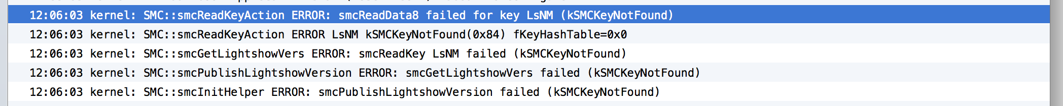

I found this. Does it talk anything?
- Screen Shot 2014-07-04 at 12.15.51.png (93.64 KiB) Viewed 64441 times

Re: MFC freezes when Macbook is running on battery
tanvip99999
So it freezes on Windows as well when running on batteries?
Lots SMC errors in log indicate some problem with SMC kernel (I think)
I also search about SMC error, so some people said that normal, nothing went wrong.
