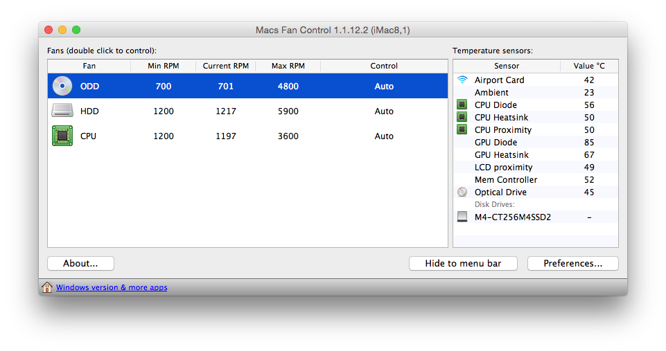

Re: App not changing fan speeds
I have the same issue, same model iMac, also running Yosemite. Same version ran fine on Mountain Lion (I booted into a clone last night to see if it still worked and it did).
- Screen Shot 2014-10-21 at 10.59.07 AM.png (90.49 KiB) Viewed 11139 times
BertholdBarz
Thanks for the information. I wish I has the same iMac to reproduce the issue. Is there anything in Console?
