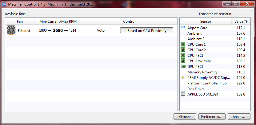

Re: MacsFanControl crashes on Windows 7
Steven,
WOOHOO!!!!
No errors or problems during install. MFC after install started with no problems too. I haven't done a reboot yet but that is next.
Here is the "technical info" and the screen shoot of the MFC app working.
Thank you VERY MUCH!!!
WOOHOO!!!!
- MFC-Technical Info-v1.4.3-devbuild-281-06-07-2016-1614.txt
- (1.71 KiB) Downloaded 2531 times
- MFC_01_6-07-2016-at-1614p.PNG (80.01 KiB) Viewed 63328 times
