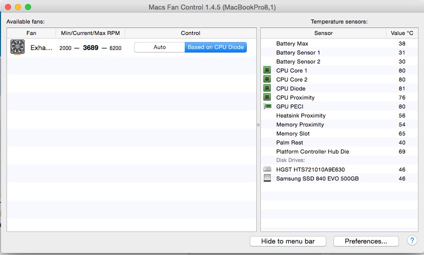

Posted: 08 Jan 2017, 12:01
by banjopotato
I have this problem consistently. Setting MFC to Custom Control (measuring temp on CPU Diode, fan increasing from 65C to a max of 99C with min fan at 2000 and max fan at 6200) consistently results in kernel_task starting to take upwards of 200% of CPU and slowing down the machine to the point that it become unusable. Setting MFC back to automatic gets kernel_task back to something more reasonable.
The thing is: it takes a while for the kernel_task problem to appear. But it does so consistently.
Screenshot:
Technical info:
Macs Fan Control 1.4.5
MacBookPro8,1
CPU: Intel(R) Core(TM) i5-2435M CPU @ 2.40GHz [100]
GPU: Intel HD Graphics 3000
macOS 10.10.5
Exhaust-min{2000}curr{4006}max{6200}mode{2,TC0D,65,99}
TB0T (Battery Max) - 37.6992, 37.6992
TB1T (Battery Sensor 1) - 31, 31
TB2T (Battery Sensor 2) - 30.3984, 30.3984
TC0C () - 81.7969, 81.7969
TC0D (CPU Diode) - 81.625, 81.625
TC0E () - 83.5117, 83.5117
TC0F () - 84.207, 84.207
TC0J () - 0.695312, 0.695312
TC0P (CPU Proximity) - 75.75, 75.75
TC1C (CPU Core 1) - 80, 80
TC2C (CPU Core 2) - 81, 81
TCGC (GPU PECI) - 81, 81
TCSA () - 80, 80
TCTD () - -1, 255.871
TM0P (Memory Proximity) - 53.875, 53.875
TM0S (Memory Slot) - 64.8438, 64.8438
TMBS () - -1, 0
TP0P () - 59.375, 59.375
TPCD (Platform Controller Hub Die) - 70, 70
TW0P () - -1, 129
Th1H (Heatsink Proximity) - 56.5, 56.5
Ts0P (Palm Rest) - 39.625, 39.625
Ts0S () - 51.6172, 51.6172
HGST HTS721010A9E630 - 46
Samsung SSD 840 EVO 500GB - 46

How long does it take to wait until kernel_task eats out the CPU ?
